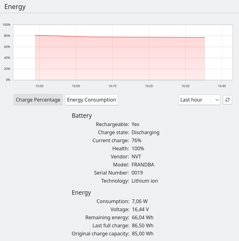

to be honest, on my FW16/AM - I don’t hibrenate, but all the rest works out of the boxSuspend & Co. and power usage is quite low.
