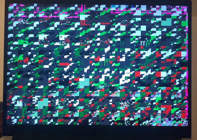

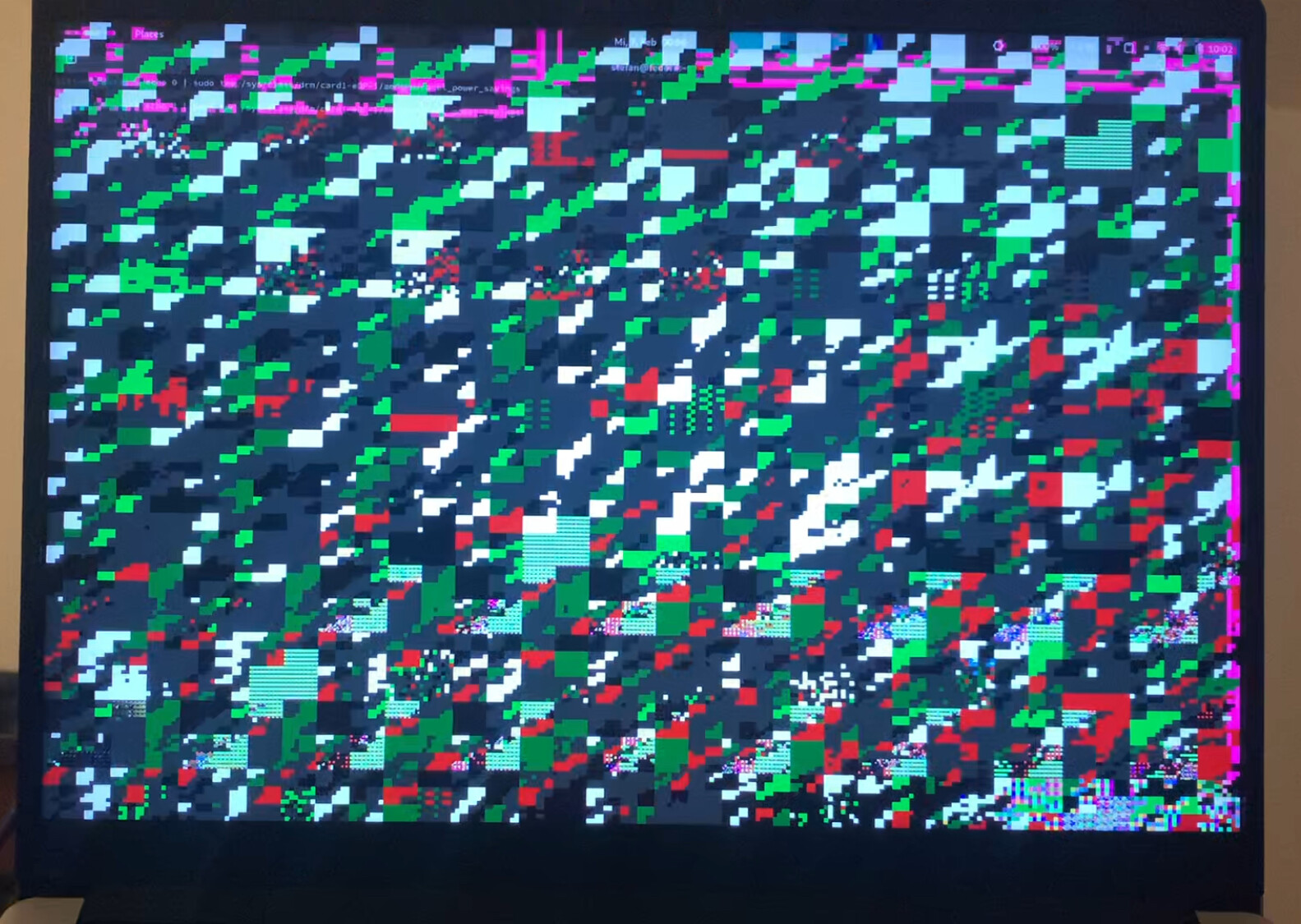

I applied your patch and it works to change the ABM level.
But sometimes I get flickering after I change the value.
When changing the value again it disappears.
~1sec I see this, then ~1sec the normal screen and this repeats until I change the value again.
I also have a video of it, but cannot upload it here
