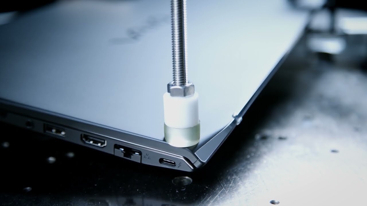

The VAIO Pro PG product page (wording of “certified”):
Press release:
https://biz.vaio.com/shop/pages/pg31.aspx

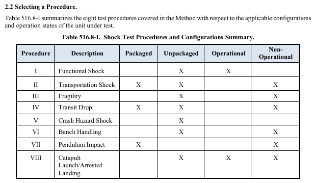

For example, the drop test, I’m guessing it was likely a logistic transit drop test, total of 26 drops? (As opposed to a tactical drop)
Reference: https://cvgstrategy.com/wp-content/uploads/2019/03/MIL-STD-810H.pdf
