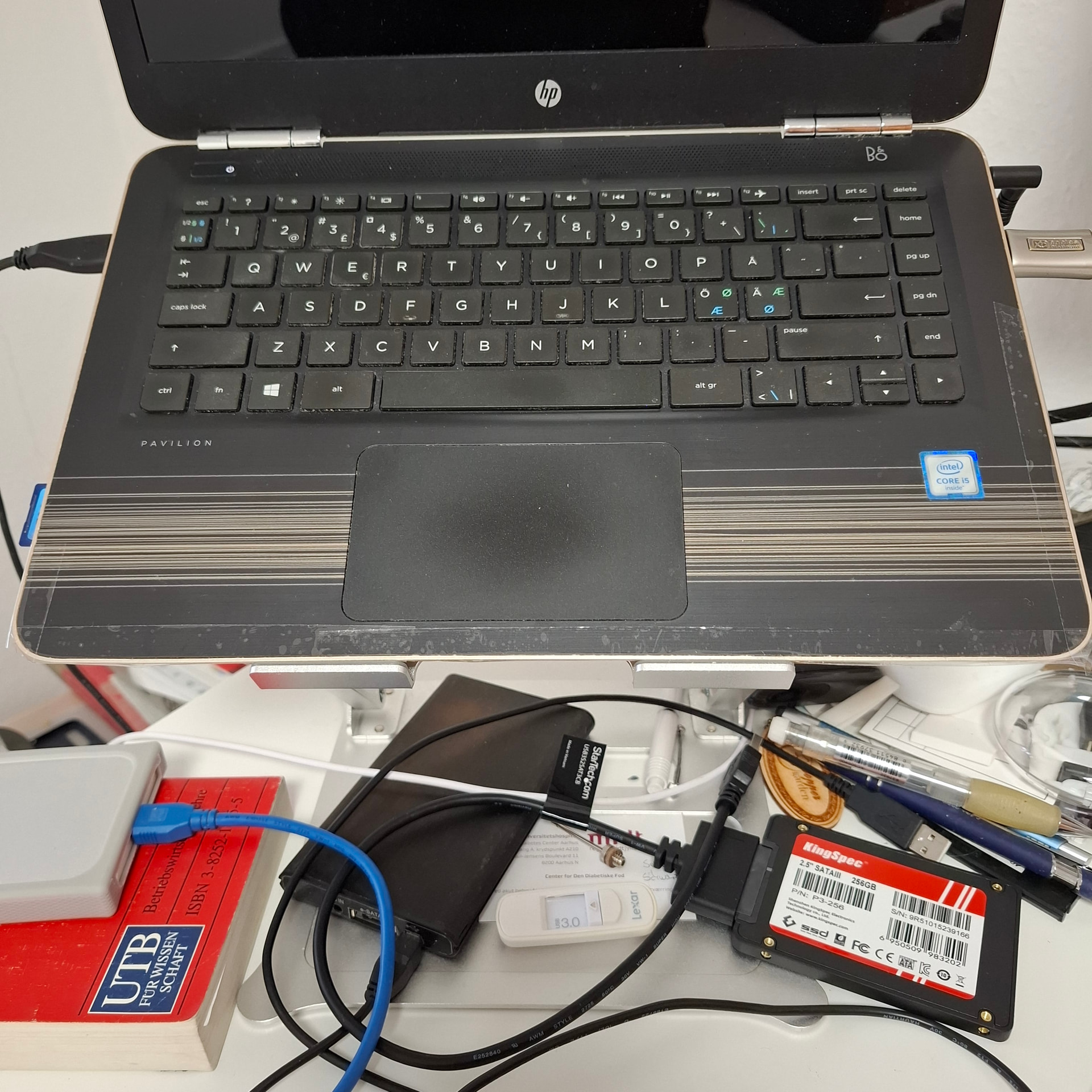

2. On my current HP Pavilion, I literally taped over the aluminum frame parts (works surprisingly well :grinning_face_with_smiling_eyes:)

What kind of tape did you use?
Happen to have a picture?
I don’t know what your willingness & freedom to DIY, or budget for paying a company to do something is. But spray paint, or much better powder coating, feels like it could be a workable solution. If you have the budget for it, I’d suggest paying to have the input cover frame powder coated. It’s harder & more durable than regular spray paint. I would think any decent service could mask off the underside & screw holes.
I used what I had… tesa tape.
