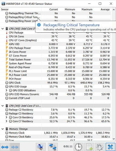

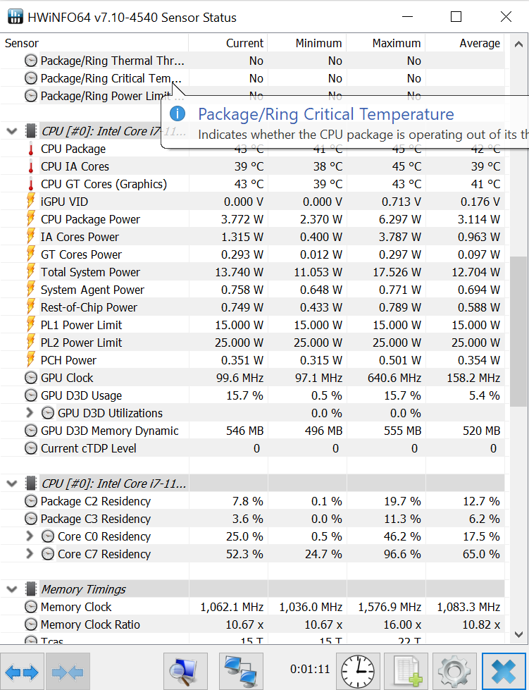

I have pretty high “total system power” in hwinfo, usually 10w+. “cpu package power” seems to be around 4-5w.
