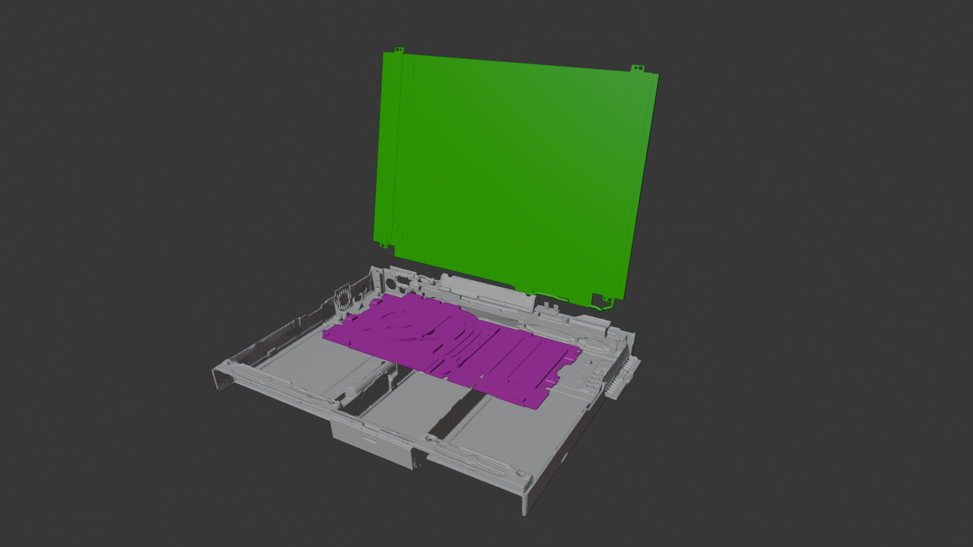

This is a 1995 Compaq LTE 5300. And it has a gimmick that Apple didn’t “invent” until 2016. It’s also chonky and at the moment broken, which is why I’m gutting this machine and rebuilding it with a Framework mainboard.
Why attempt this? I think I speak for many here when I say I desire something unique that I can relate to as my daily driver, that will be by my side for many years. In three years, every other generic laptop you could buy today will be a slow, unrepairable e-waste. That’s why I’m turning to the Framework ecosystem. If it works, you’ve got a genuinely future-proof vintage beige brick.
Also, it’s funny.

My friend quickly scanning the Beige with his Framework 13 (which I envy), gave me a clearer idea of how this project might look. And the answer is a lot of Dremel, 3D printing and hobby glue.
Room really is not the issue the Compaq has, quite the opposite in fact. My goal is to get enough batteries in there to get me on a no-fly list, but besides that there are awesome Cyberdecky things that could be put in there like meshtastic. And using a salvaged USB-C Dock I expect epic User IO.
A big hurdle I expect coming my way will be the screen. Yes, believe it or not, I have no desire to make a custom adapter for the original 320p screen, as legendary as it might have been back in its day. Yet, even with 3D printing a custom front shell, I expect it will be a tight squeeze.

Also, are all those IR tracking marks for the scanning? I’ve not heard of 3D scanners that use those before.
Yeah got a bad case of the 3D scanning pox xD It was scanned using my friends Revopoint inspire 2 which does a pretty okay job for being a consumer scanner, the IR dots really help its software.

The Compaq laptop in your picture has some large slots for a Floppy or Hard disk.
Maybe for your rebuild with a FW mainboard, use those slots to fit extra batteries?
The cooling fan might be a challenge though, getting the airflow needed.
The Compaq could also probably use a variety of display panels out on the market today, as there is probably depth to fit any of the them, and also a small signal adapter PCB to adapt from the FW pinout to the pinout needed for the panel you choose.
The standard compac case has a pretty huge slots in the rear for ports that i dont even know what they do. i think the framework cooling will use those just fine. Thank you for the input!
