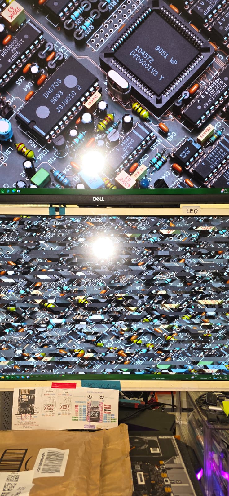

So I have a Gen 1 framework 16 bought in 2023, I recently upgraded to the 5070 from the 7700s.
Every day, i plug 2 Dell docks into my computer, one into one of the compatible C ports, and one into the GPU.
This drives 4 x 4k displays at 60hz and has worked mostly flawlessly for a long time.

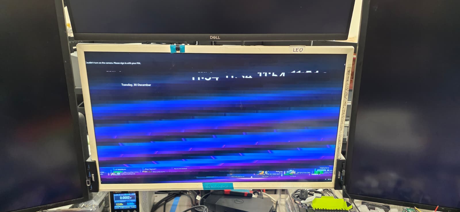

After upgrading to the 5070, I get the issue show in the photos where on first connect the GPU connected dock will either just not detect the DisplayPort display (white), or will detect both, but have a corrupted image to the DisplayPort display. additionally, nine times out of 10, the other two displays will detect a blank signal.
Now this is where it gets really strange, with both docks connected and not functioning properly, if i unplug and re-plug only the DisplayPort display, everything will start working properly as if there was never a fault, but if i unplug a dock and re-plug, the same issue will occur.
