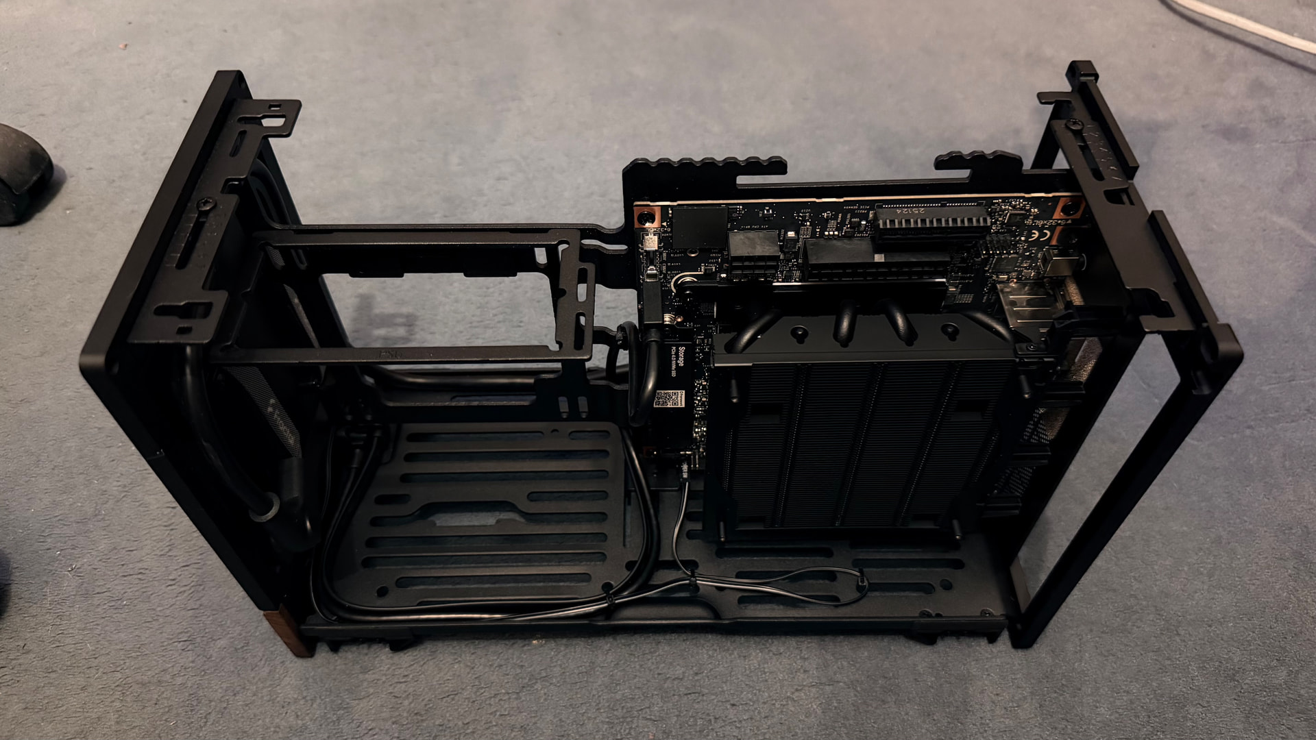

I am currently in the process of assembling it, however I am missing the fan, the psu and the ssd :melting_face:
Seems to me there should be enough Space for the fan though.
I had however to remove the sencondary ssd locking mechanism/cooler as it was pressing against the chassis (damn it was so close to fit perfectly!)
Sweet! Good luck with the build—the Terra is such a cute case.
I think I’ve seen a few people talking about that bottom SSD cooler getting in the way unless you do something with standoffs…
Thanks :slight_smile:
I thought about doing so but then the back panel would not fit/be aligned with the cut in the back of the case :confused:
The hinge on the heat spreader is quite large and protrudes a lot. I had the same issue, ending up installing higher standoffs. The alighnment with the rear panel is out just slightly but still functional. Of course, I could have removed the spreader and used thick thermal pad instead

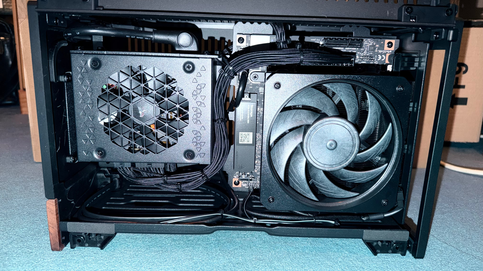

Hi all, here is the baby now fully assembled!
I must admit the process of assembling it was not as smooth as I had anticipated, mostly out of stress of doing wrong, but I am pleased with the result. Only thing I’m a bit frustrated about is the fact I learned after receiving it that the fractal case in black gets marked with anything on the front panel. It can be cleaned but it doesn’t feel as premium as the price was.

Interesting, what did you use qua (specs) for PSU, Fan, SSD?

https://community.frame.work/t/desktop-build-with-gan-psu this my build.
I went a little overkill for the psu :laughing:
I always have worked with corsair, they are very good quality PSUs. This time I went for the SF850. 850w is way overkill but the fans never turn on, it is rated platinium, so very high efficiency, and it cost me the same price the framework psu was.
For the ssd I went with a SN8100 although a SN850x would have done a great job too.
The fan is the same one as framework recommendation, a noctua, but i went for the new black version I found much more pleasant looking
Yes 850w is abit overkill, but it’s SFX so it will ways be overkill as I have not seen one lower than 650w. Atleast you get platinium efficiency at full load :stuck_out_tongue: and may be 80% at idle.
Also did you use a normal width fan (2.5mm), I’m asking because on paper this should not fit with that case max moveble spine? Also did you install wifi-card, if so what is your antenna setup. As that case is aluminum case I think, so a antenna should be outside the faraday cage.
I went for NF-A12x25 PWM chromax.black.swap, which is indeed 120x120x25. Someone told me the same but i didn’t encounter any issue while mounting it inside the case, i have a bin margin left.
