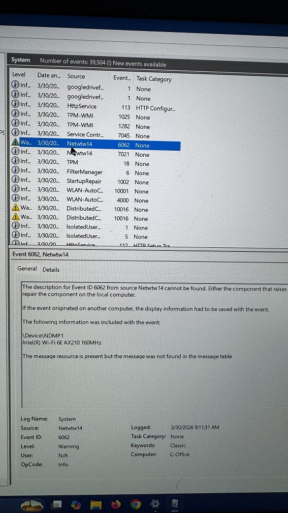

Hello all. I’ve been using my Framework 16 (win11, Ryzen 7040) for mostly work, and light gaming for… 2? years now. It’s been working great, but I just ran into a boot loop problem. Strangely, event viewer is pointing to 2 different problems.
The first, seemingly more major, appears to be a display issue. The laptop boots, then the screen goes black.
I get a series of DCOM 1084 “ShellHWDetection” and “camsvc” errors in my event viewer. Event 10005.
The second is I recently updated to the newer Intel Wi-Fi 6E AX210. It installs fine, and runs….ok? I’m also occasionally getting Nettwtw14 errors. I had used windows drivers, but then swapped to the ones from the framework site, in case there was a discrepancy. No idea why it keeps erroring.
