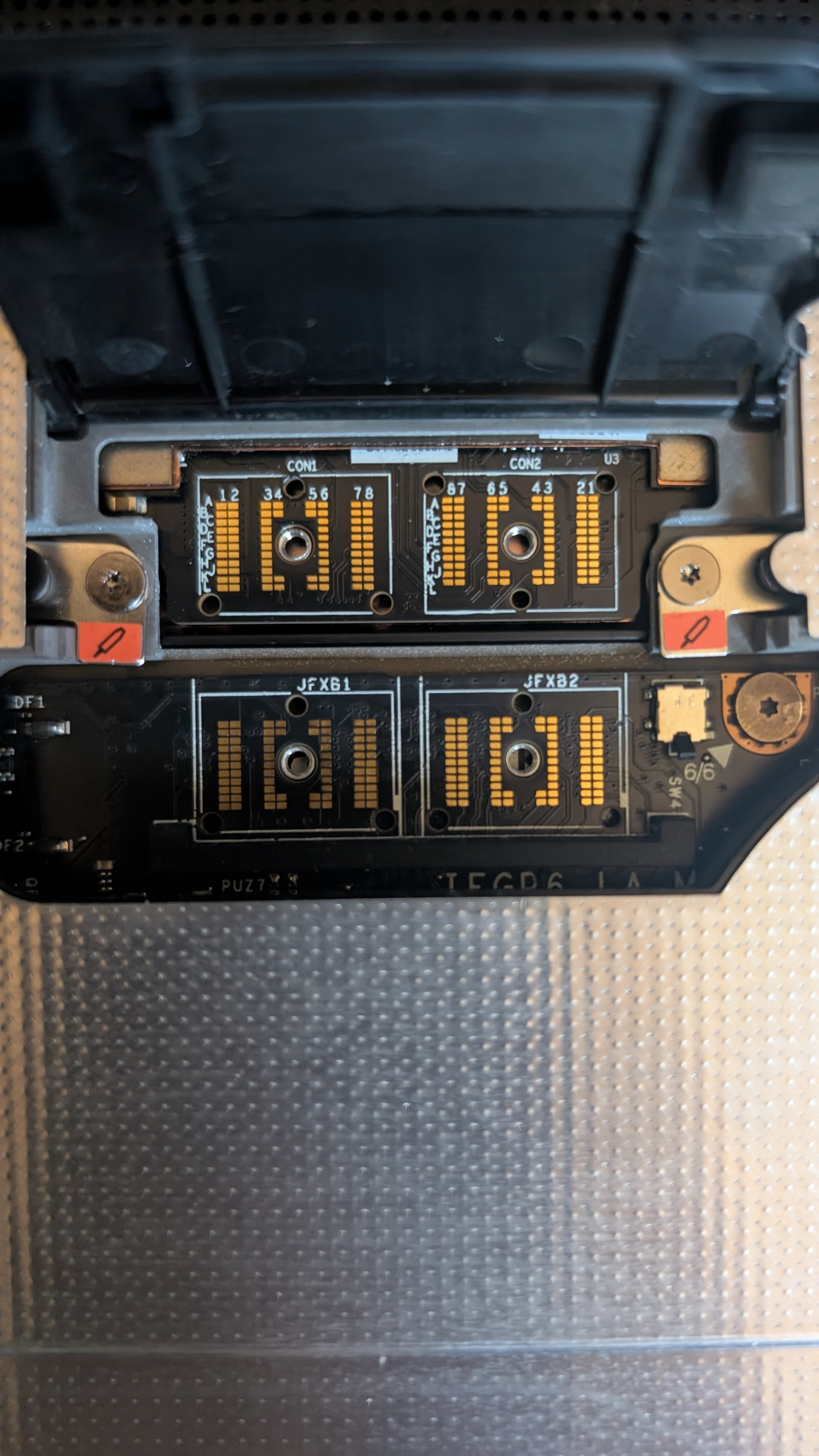

I’d check the interposer for pin damage, might want to post a picture, betting support will want this photo too, and check the pads on both the motherboard and the expansion module for damage, a photo might be good and I’d bet support probably would want a photo of that as well.
I just dowloaded the bios 3.05 and the gpu is still not showing up… i will take pictures of the interposer and post them below
i tried to take pictures of each pads but the pics looked to blurry i really dont think the connector is an issues. While i was at it i cleaned everything with rubbing alcohol gently rubbing the pad in case i touched it with my bare hands. And let it dried off. The gpu is still not showing.
