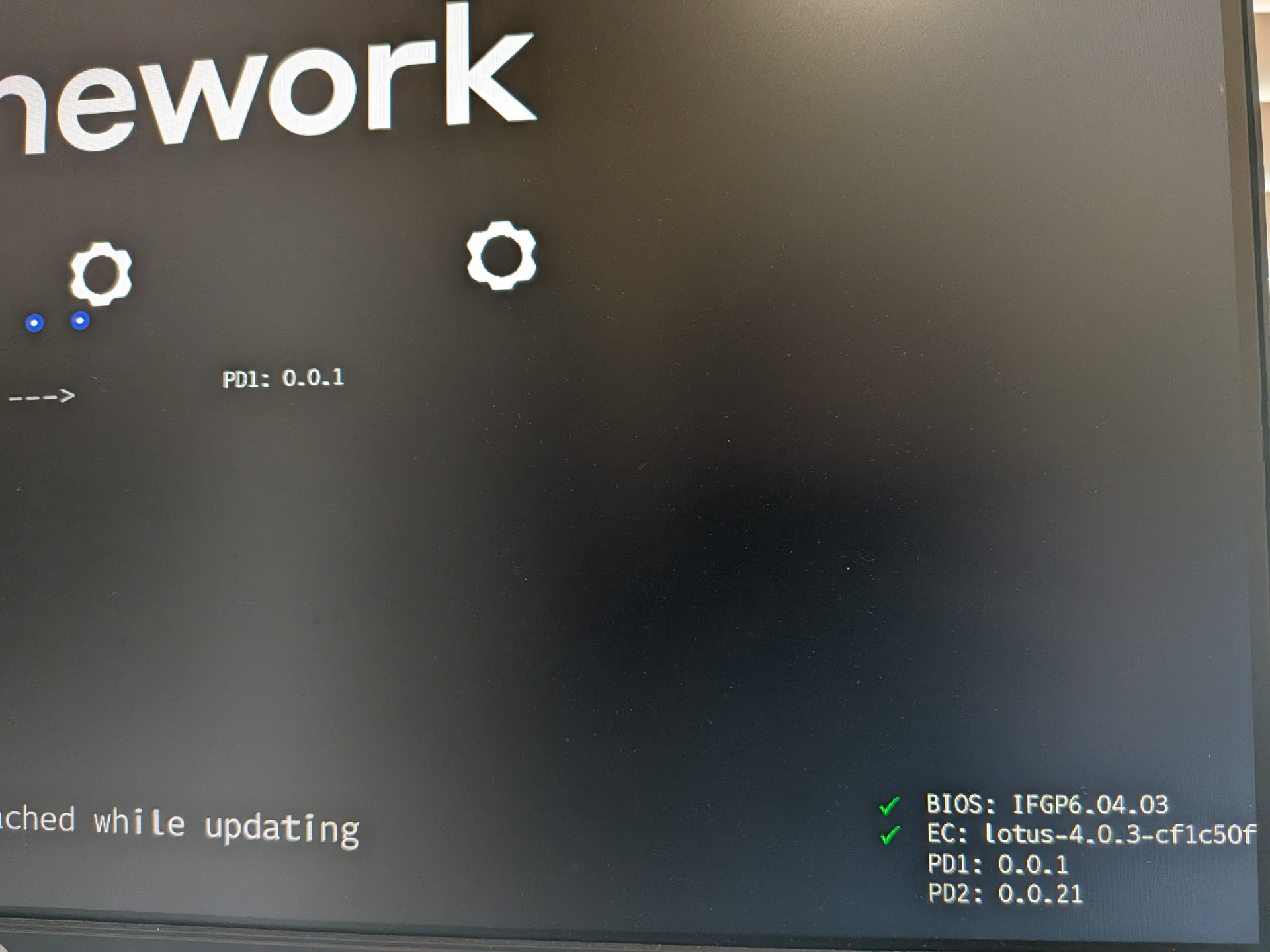

Tried EFI flashing. I get a check mark on the BIOS and EC but nothing for PD1 and PD2.
please reach out to framework support. I’m running out of idea what is wrong. based on what I see in my FW 16, both PD controllers should be using 0.0.21
