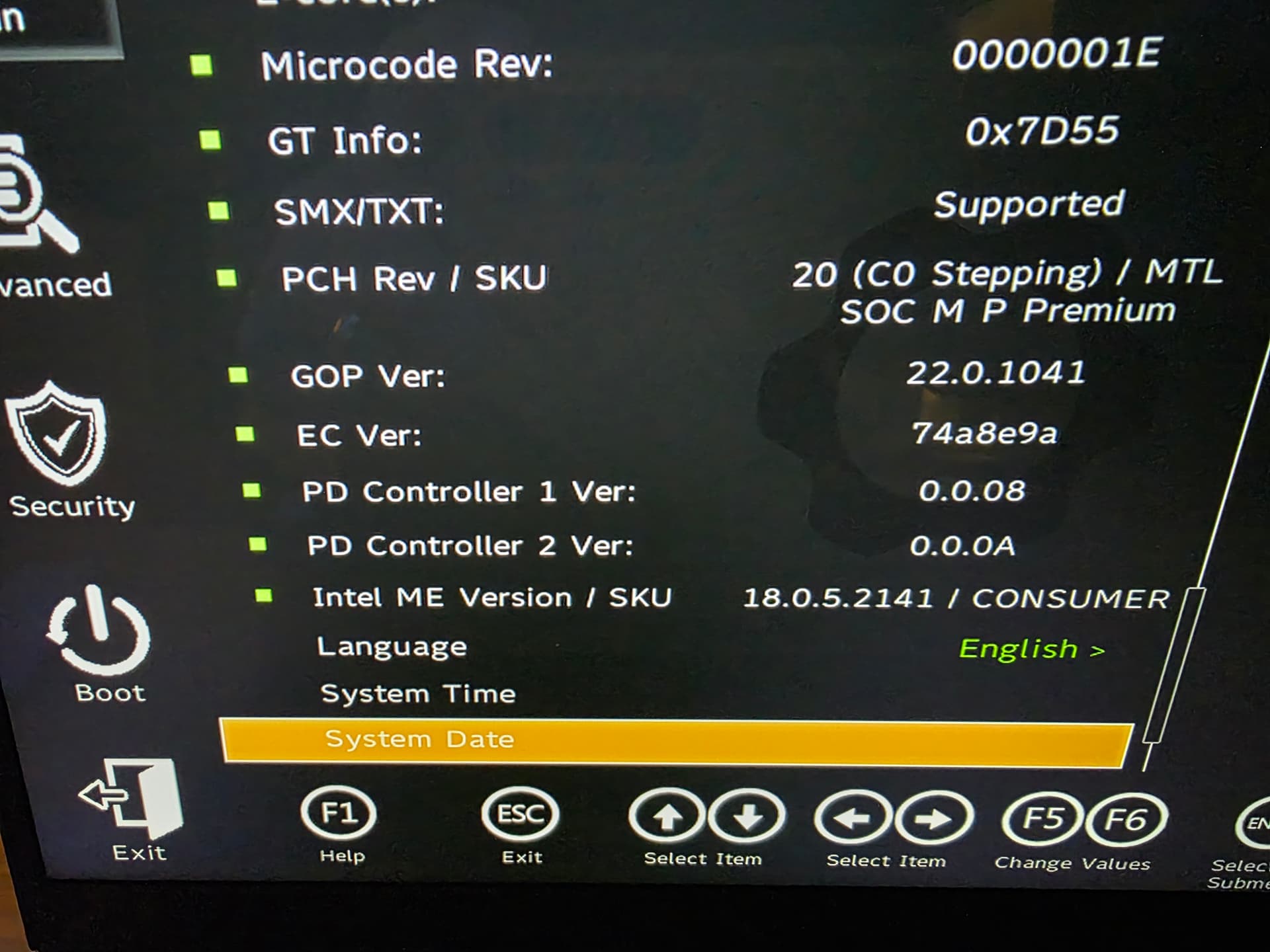

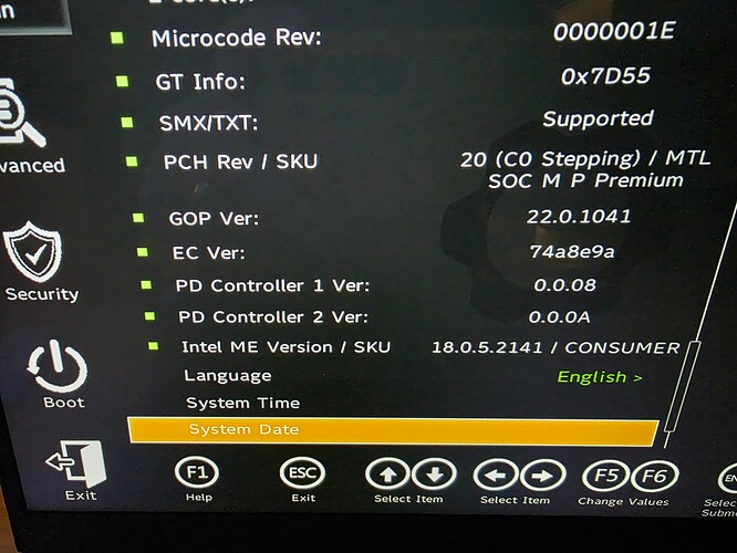

After doing this from Windows (running all 4 steps sequentially, no failures observed), I see two different versions of the PD BIOS when I go into the bios after the update. PD Controller 1 shows 0.0.08 while PD Controller 2 shows 0.0.0A.
I tried switching the power to the other side and running the bios update (part 4) again, but it stays the same. It shows a checkmark on the flash screen by PD2 but just leaves PD1 alone. What can I do to fix this?
I hit this too when updating using the UEFI method.
The only way I was able to resolve this was to install Windows and use the Windows updater to reinstall Step4.

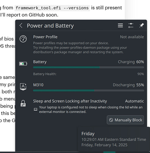

I’m also seeing some weird behavior that might be BIOS related.
OS: Manjaro Linux
Kernel: 6.13.0-1-MANJARO
  1. When docked to my Caldigit TS4, I am unable to see the GRUB menu. Both my primary (built-in) and secondary (external) displays remain black, I get no output though both monitors are ā€œonā€ (i.e. not in standby). I can tell that the machine is just sitting at the grub menu because if I hit enter, the machine starts booting normally. If I reboot without being plugged in to the dock, I can reach the GRUB menu no problem. I don’t remember this being a problem before, though I also don’t remember ever needing to break into the GRUB menu, so this might be a red herring.
  2. Also when docked (though only sometimes), plymouthd never quits which holds up several systemd units from completing… I stumbled on this because the KDE Power and Battery menu started reporting that power profiles were not available. For fun, I reinstalled Manjaro using the latest ISO and the issue remains. However, I also reinstalled Manjaro from the ISO I used back in August when I got this board and I can’t seem to replicate this issue there.

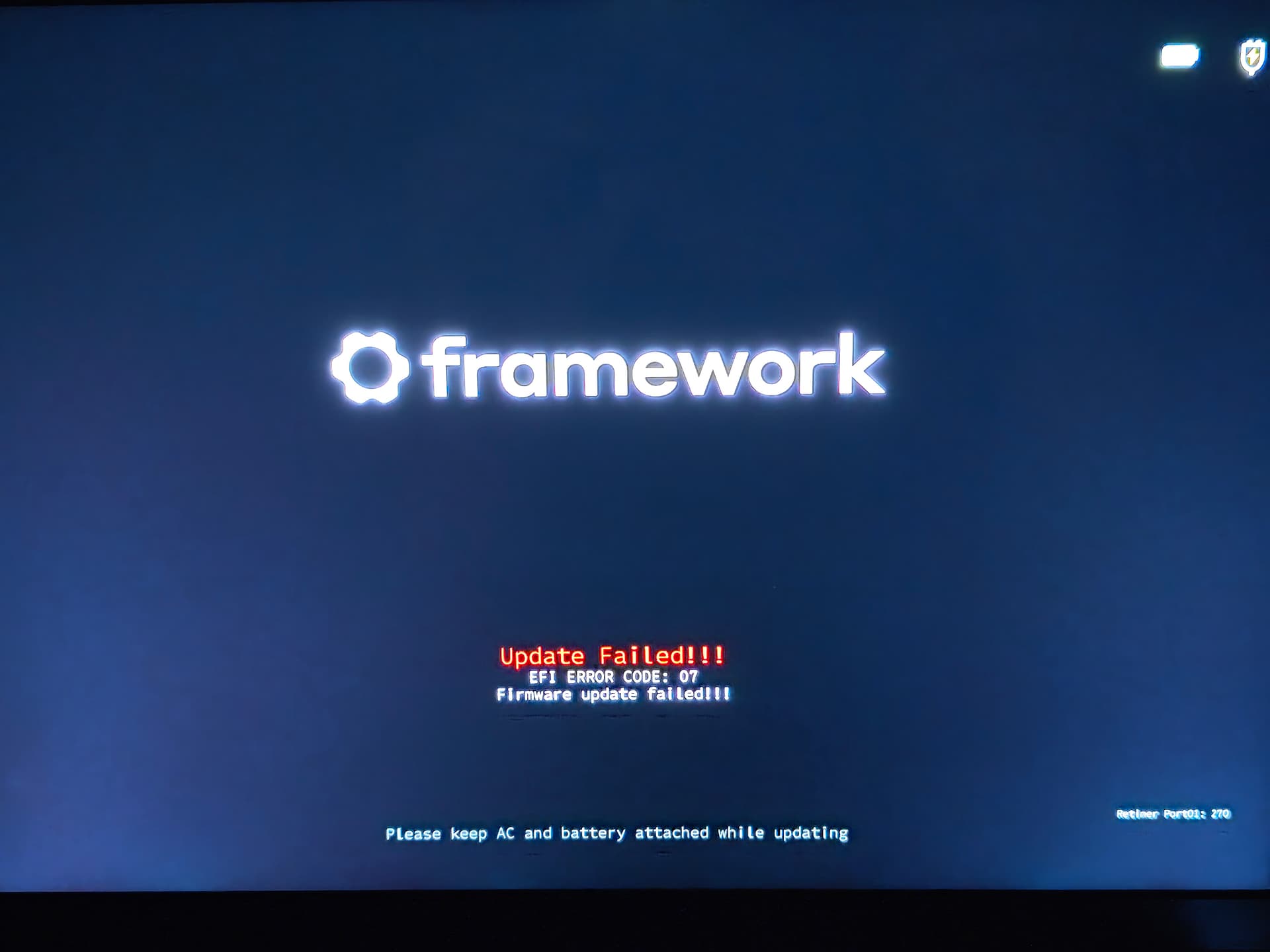

Hello with Windows method, I’m stuck on step 2.
It’s giving me:
Update Failed!!!
EFI ERROR CODE: 07
Firmware update failed!!!
Step 1 ran just fine.
I am now on bios 03.03 (was on 03.01 before step 1).
I tried to plug the power cable in another port.
I tried to manually suspend BitLocker.
I always unplug all extensions cards except for the one being used for power.
