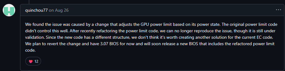

I cannot say for 240W chargers, but 140W ones still experience the same unstable dGPU clock which results in constant stuttering.
Can confirm bug persistance for 140W USB-C (Baseus).
With stock Framework 180w, battery drain in “Balanced” is solved. Played 2hrs of Battlefield 6, went from 84 to 95%.
Next week I’ll test the Delta 240W.
I tried with the Delta 240W charger and there was no stuttering at all.
Battery capped at 90% and saw 100W on dGPU without battery drain.
Allowed it to drop a few percent and no stuttering while gaming and battery was recharging back to 90%.

It is unfortunate to see that even up to 4.1Beta there are still issues present. I do like to see that some folks are reporting the power studder/jitter seems to have improved. But only seeing reports for the 180w thus far. Curious if it solved the 240w? I’m hesitant to update seeing that some folks are having boot/post and expansion module issues.
Artem_Puzikov posted the 240w stutter issue has been resolved in this version up above.
And in my mind, anything below the 180w supply should not be expected to provide good gaming performance on a dGPU, so I would let those issues go.
