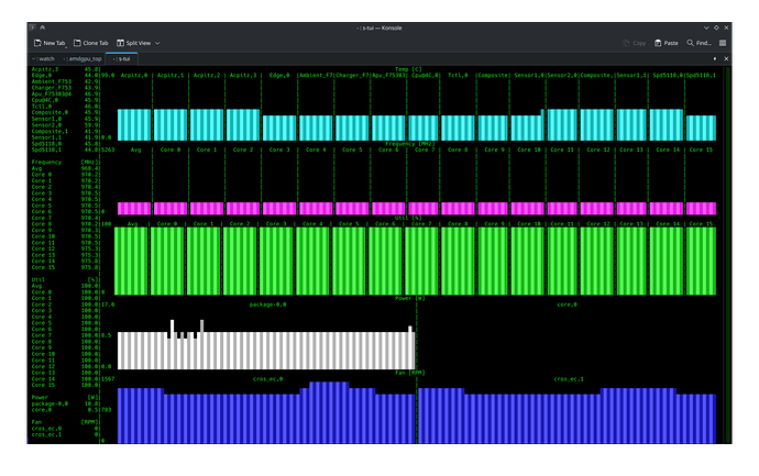

s-tui screenshot while in stress mode:
Looks like it is limiting it to 10 watts when all cores are stressed. Which is insane. This is at a 5 day uptime. I think a reboot will mitigate the issue, but that should not be needed. Why are they not fixing it?

I had the official Framework 180w connected when taking those s-tui screenshots.
