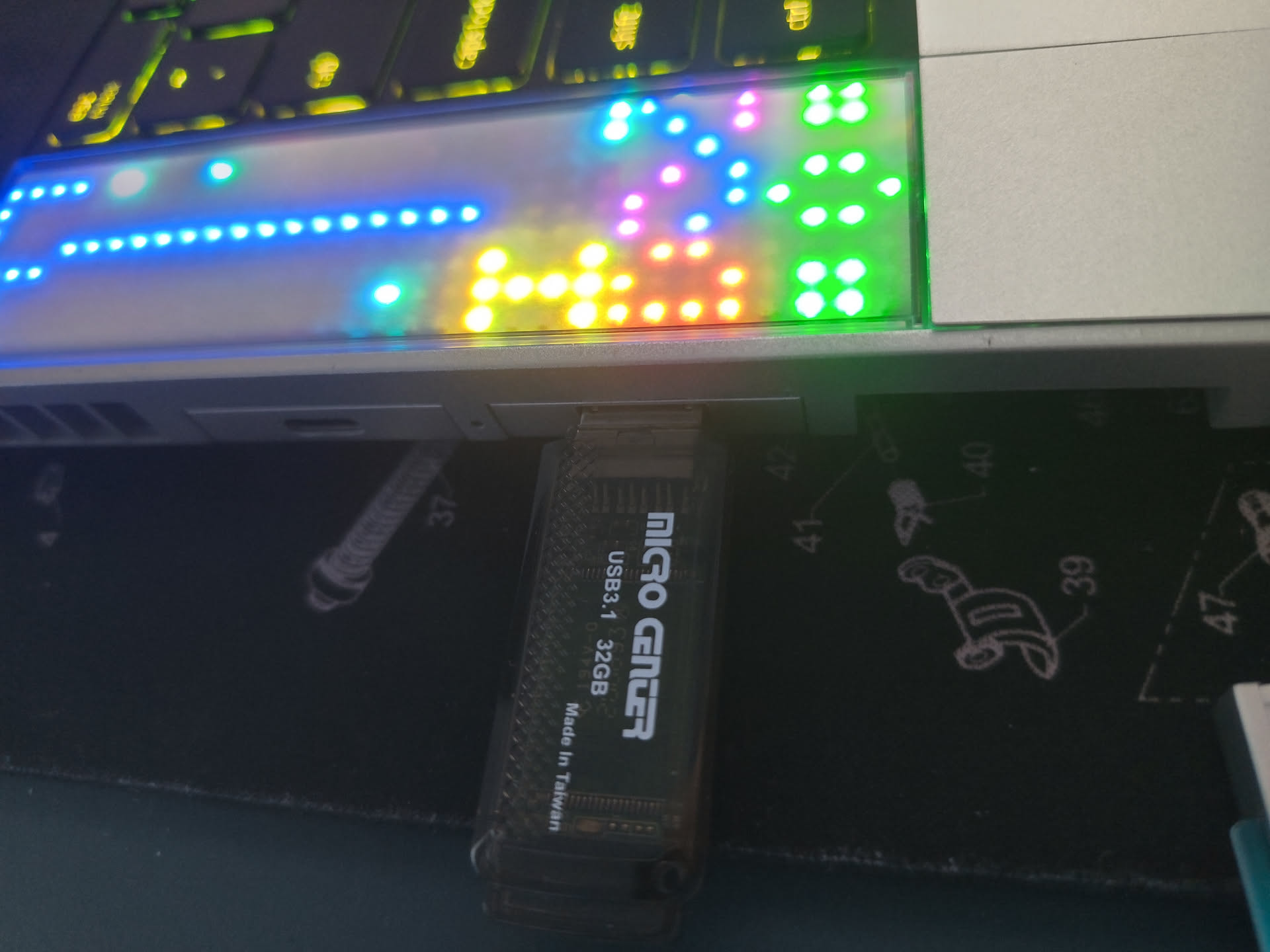

I know it affects all of my USB-A 3.x flash drives. It didn’t appear to be an issue with USB 2.0 drives. The nuisance port is the left middle one on my Framework 16. I downgraded to v3.05, then back up to 4.03 again. The issue only appears on 4.03. I’ve downgraded to 3.07 for the timebeing.
I have a bug open for this - for me its the “right middle” (port 5) and happens after a sleep cycle.
Wow you are totally right! I tested it on mine and was able to reproduce. Sure enough, on the third disconnect, it will not reconnect again until the usb A module is removed and re-inserted. That’s crazy lol.
And get this, I also tested this issue on the right middle port (port 5) and the following happened on the third disconnect (my dock is connected to port 4) The “over-current condition” look concerning:

I was reproducing it with this usb drive:
