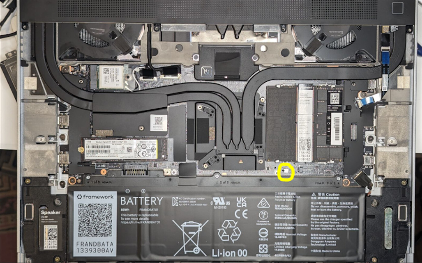

title says it all. i stepped away for a few minutes, came back, and literally watched it croak. i’ve already reached out to support, but i fear i’m out of warranty so i may be boned. i’m not sure how much it took with it. i’m not even sure if this is a cry for help or just to vent. i do have a video of me showing the issue to a friend and you can see smoke coming out of the left side of the board.
update: the 180 watt charger is also dead. so most likely culprit is a power surge. i do have a second charger on hand i could try testing the mainboard with, but im terrified that this thing will kill anything i plug into it now
i worked up the courage to plug in a sacrificial power bank and the board showed signs of life! 2 solid white leds on both sides. no response to the power button, but i don’t know how to trigger a power on without it. progress, though!

signs of life! the laptop doesn’t respond to the power button (it might be dead, i have no way to know), and one of the ram sticks passed memtest in my laptop 12. any ideas?
You can try holding down the intrusion switch (right below the left ram module) and see if it boots. But I honestly don’t know if it needs all the input modules installed as well for that to work or not.
no dice, i’m not getting fanspin or anything

i’m currently in touch with framework support, they’re trying to troubleshoot because the boards are both showing some signs of life. in case someone’s in the same boat as me, here’s the steps they provided.
For both laptops:
  1. Try to remove SSD and RAM, then try again to boot.
  2. Perform a mainboard reset
  • For Framework Laptop 16
  • Plug in the system to AC.
  • Remove the Input modules.
  • Press the SW3 switch in the lower part of the RAM slot (encircled in yellow), you must press it slowly, so press for 2 seconds. Release, wait for the red blink on the Mainboard LEDs. repeat.
  • Press the power button to boot the system
  • BIOS settings will be reset to defaults.
