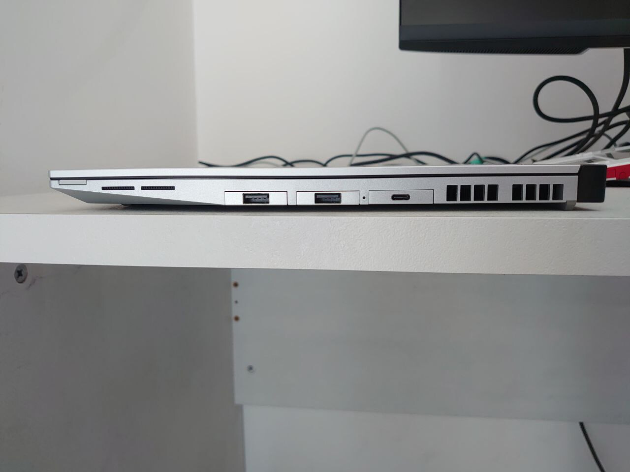

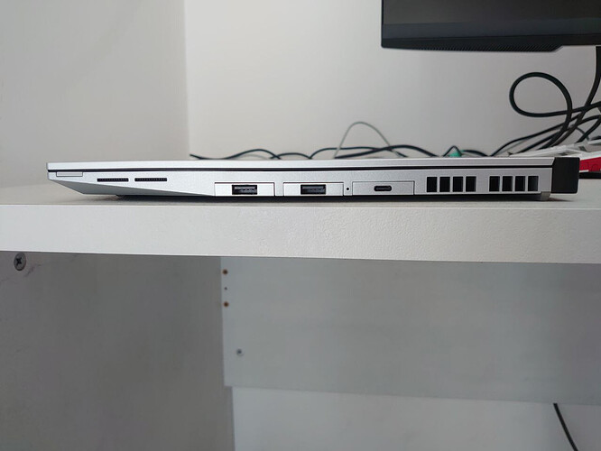

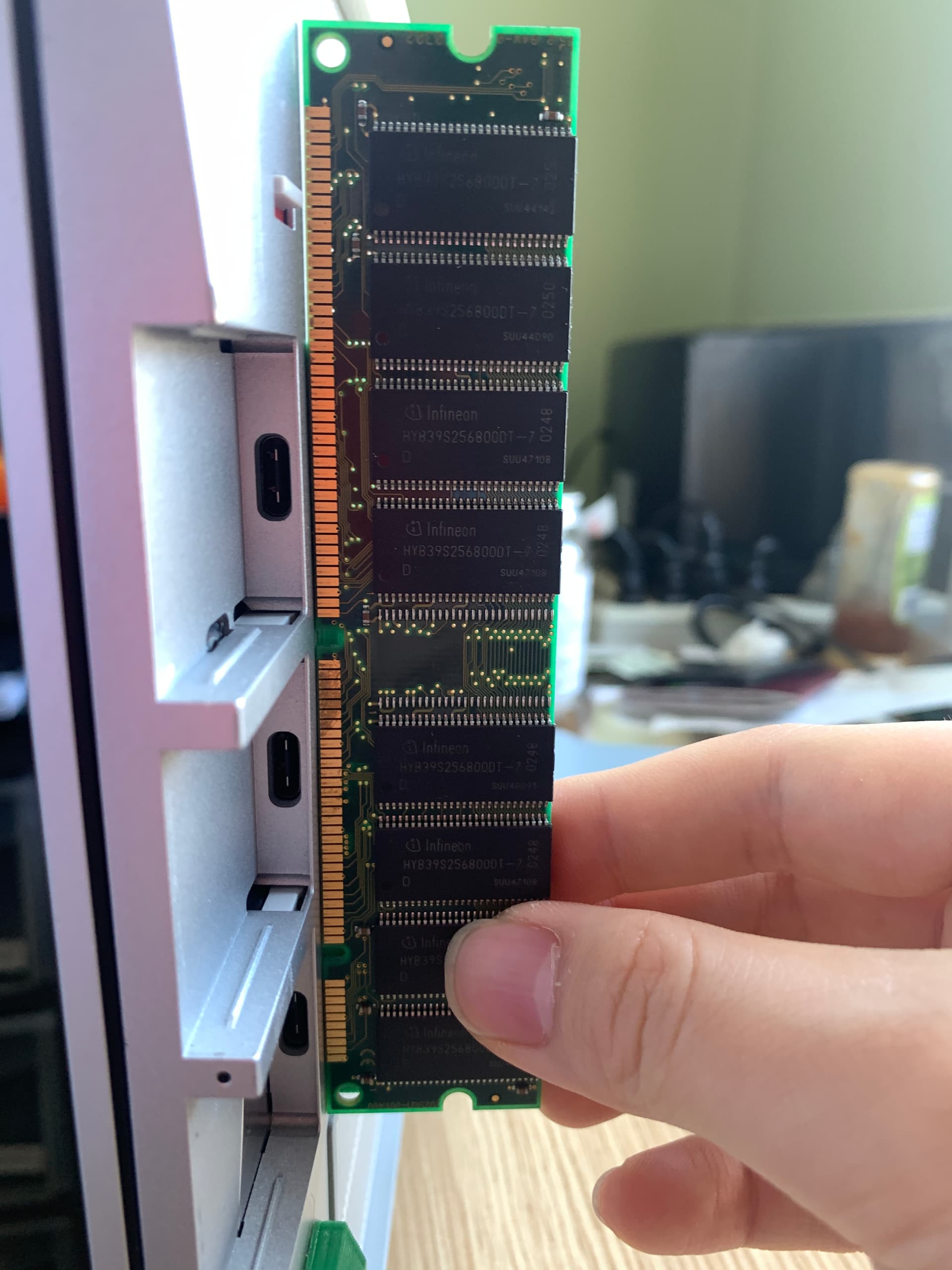

Decided to check again since I have been feeling the entire laptop bend down under my hands pretty hard as of late.
Wooow. This is honestly really bad. At least this unit genuinely has a cardboard-quality chassis
Wow that is actually garbage. What the heck?
On mine it’s better, but still.
It’s a lot flatter on the sides, presumably due to the feet, but probably also due to the side of the laptop sticking out.
the bottom bit, which for the longest time, don’t have anything supporting it. All the clear feet you see in this picture is gone. They also dont really reach, so …
Thanks for the sanity check. I really can’t afford to be without my laptop right now (high likelihood this will be yet another stop at the service center…) so I cannot open a ticket until all the tight graduation and job - related deadlines are over. But when they are, I will actually try to press for a brand new unit, because I believe I have reached the point where repairs won’t do it anymore: this unit needs to be replaced as a whole. It’s clearly a lemon and it doesn’t get any clearer than that honestly.

  1. The chassis is not a uniformly thick slab. The thinnest is around where the main board sits, which is right in the middle area. Less than 1/32 inch.
  2. The board don’t have any screws in the middle. I don’t know if you have ever disassembled the thing, but I don’t recall seeing any screw in the middle of the PCB. Not to the chassis. So, your board is probably fine.
  3. While bending is not ideal, it’s not that crazy. Powercolor’s GPU board actually seem to be a ± 2mm (across maybe 200mm, so 1%).
    Yours seem to be on the crazier side, so … better print my improved feet.

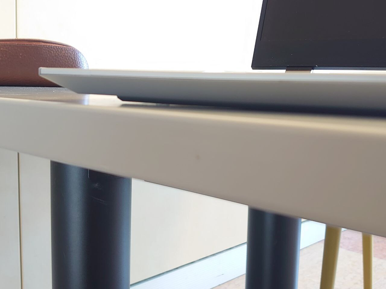

Just a passing comment. I think the bottom of the FW16 laptop comes from the factory with that amount of bend on the bottom.
For example, my laptop has exactly the same amount of bend as yours does, and I have a very light tough, so I would not have caused any bend.
Just to clarify, the top of the laptop, where the keys and touchpad are is not bent.
The underside of the laptop is bent. Maybe bent is not the right work. Curved maybe.

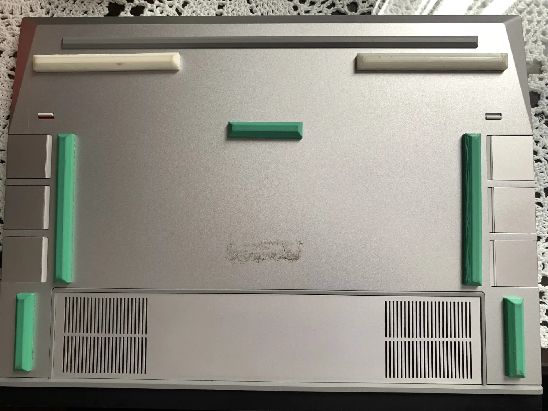

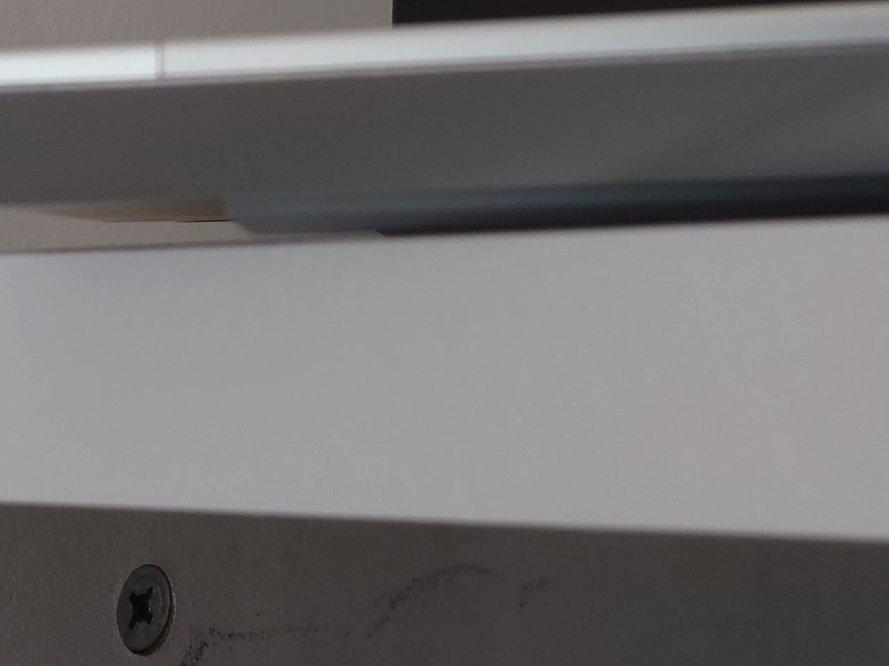

New(ish) feet. It’s been a while.
They are 10mm wide by 8mm tall blocks of solid TPU. Kind of massive overkill, but these are just double sided tape on, I want them to not come off. I think short ones are like, 50mm while long ones are 100.
8mm is also probably overkill, you just need them to clear the stock rubber feet. On both the GPU and near the palmrest. You want to keep the bottom (which is completely flat) completely flat respective to a table.

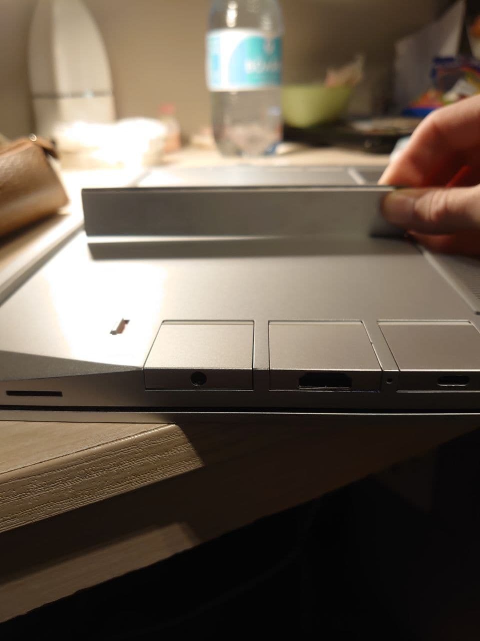

My laptop came back from Support. The good news is they diagnosed a bent bottom case and they replaced it. The bad news is… the new bottom case is bent, too.
It is not as bent as my older one was, I think it’s closer to what OP has now. I also don’t get the same “rattling” effect now, and the expansion cards no longer rattle in their slots. Typing on the keyboard finally feels “proper”, it does not bend under my hand. Even clicking on the touchpad feels better, and the touchpad no longer “falls” to one side. The laptop feels firmer, and the keyboard is less bent. But the chassis is still not straight.
overall laptop:
Immediately, it does not look perfectly straight, but it’s also not a banana. Scroll up this thread and check out of bad it was before this fix.
Let’s take a closer look at the rubber feet:
Same symptom. Mind you, this is a brand new case, laptop received as it is, straight out of the box.
Unless Framework is replacing a defective part with another defective part - which I do not believe, the QA cannot possibly be that bad (the new part has a small dent in an expansion card port, but I chalk this up to tolerances) - I have reason to credit the thesis where there is a design flaw with the design of this “tub”. Either that, or the Repair Center just juggles around defective / used parts from returned / repaired laptops, which I sincerely hope is not the case.
PS: Though not completely flush, my touchpad spacers (which did not change, I recognize them from the same minor scuffs and bends) fit more flush with the case now. What if all those early posts of bad touchpad spacer alignment were actually just bent bottom cases all along?

You can try to 3D print (or have someone 3D print) the TPU feet I have mentioned above.
Or you can just find some equivalent-height wood (I guess) and tape them to the bottom of the machine. I can’t say they completely eliminated, but it definitely helped.

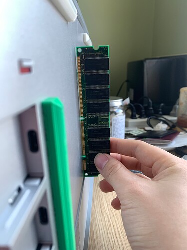

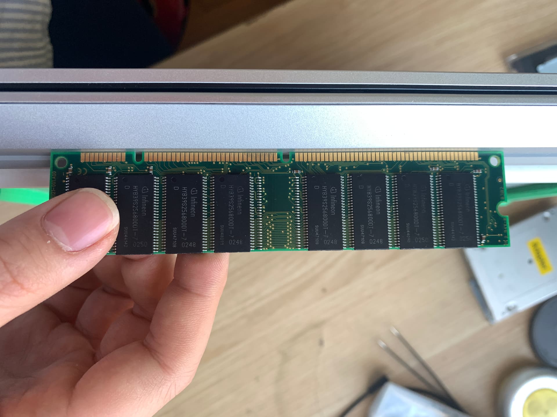

Just to confirm, does your front laptop foot also look frighteningly bent from a naked eye when the laptop is tilted?
Not really, its about 0.5mm, but yeah that does happen. You can see in my ram stick pictures, the side-to-side bow is there, but not super significant.
This actually confirm a lot of things. That one, the vertical ridge on the sides does strengthen the chassis, preventing those areas from bowing. And two, the center of the laptop is actively bending downard as if something heavy is resting on top. And so, the corners tilt up.
And also why my added 3D printed feet helps, because there is one or two near the center. However the most central dont last super long, because the intense heat weaken the adhesive. I might try two side parallel feet positioning, flanking the SoC rather than being right beneath it.
