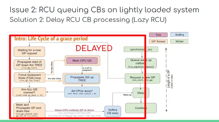

A bit late to the party but I noticed my 11th gen has considerably better battery once my VPN kill switch was enabled, I believe this is due to it disabling wifi on standby
So, just for reference for folks. I installed the Linux-Clear kernel today. I also removed the redshift package, and with these changes, I dropped my average poweruse down to about 5.47 wh, with Bluetooth and wifi active. I don’t know what that Intel kernel has going for it, but this has been a reduction of power use by about 30% for me.
I am not running any sort of power config and my i5-1240p is running amazingly.
While comparing and swapping between Fedora’s power-profiles-daemon and TLP I found that running the machine without either of them gets me exactly what I want. I get 3-4W idles and reach C10 easily. I average 5-7W when browsing. I get a .50-.60 percent battery drain per hour with the lid shut. 2D games run at about 10W average, and Portal 2 averages 16W at native res (AA disabled). If I want to run something demanding like modded minecraft, I can still get the processor cooking at about 45+ W with feral gamemode.
