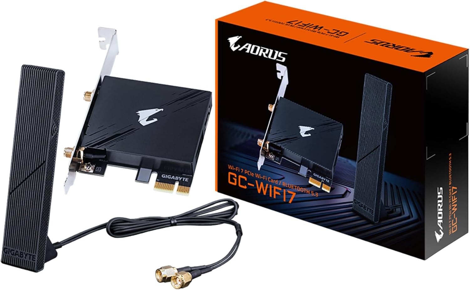

I just picked up an affordable Gigabyte branded GC-WIFI7 off Amazon, swapped the mini card from it for my RZ616. The FW wifi works in the PCIe card, and the ath12k works perfectly in my AMD FW13. Thanks to everyone who has been troubleshooting and writing patches/requesting changes, wifi7 and BT5.3 are working perfectly for me on Arch with kernel 6.13.7.
Got a link for which card you bought? I’d like to upgrade this crappy “MEDIATEK Corp. MT7922” that I’m very disappointed Framework sold to us. Wife’s Asus has the same card and they both randomly disconnect and have to reload the module (or reboot) to get them to come back. Utter junk.
I was expecting to get my FW LAN adapter out, but the mainline Arch kernel and firmware was ready to go. It resumes smoothly from sleep, no regulatory domain nonsense, it’s quite lovely.
Edit: Hmmm. Only just noticed, I ordered one used, about 30$ US, it’s only showing new for 45$ now. Used works fine, since we’re just stripping out the M.2 card anyways.
The Gigabyte GC-WIFI7 currently comes in 3 versions: 1.0, 1.1, 1.2. Each version uses a completely different chip.
1.2 is intel
1.1 is mediatek
1.0 is qualcomm
So it may not be clear which one you’re getting when you buy it, and may not be the ncm865.
Good thing Amazon return policy is pretty good. I ordered one, will see when I get it.
bluetooth fix is merged for linux 6.15
Thanks. I got a used one for $36 or so. Installed it over the weekend.
I’m on arch linux, using kernel 6.12.21-1-lts and it connected to wifi faster than the crappy Framework mediatek card ever did. Connected to my wifi7 AP just fine, but is not using 6gh, only 5gh, and throughput is much slower than the mediatek was. So I suspect it’s not utilizing any wifi7 or even 6e features. However, I experienced no dieing wifi all weekend so I consider that a win.
Bluetooth on the other hand is a mess. Keyboard works and that’s the most important. Game controller seems to connect just fine, but does not work at all. Bluetooth headphones sometimes connect, most the time fail, and never work either.
Of note, my Wife’s Asus gaming laptop also had that same mediatek card and experienced the same dieing wifi. But in her case she uses Windows 11 and has to reboot the whole machine to bring her wifi back. We installed one of these qualcomm cards in her laptop at the same time (good time to teach her how to change her own components :D), sourced from a different vendor, but using the same Gigabyte drivers to make it work in Windows and much improved there as well. At least she hasn’t complained yet.
You may need to tell Linux where you are in the world, before it will attempt to use the 6GHz band. I had to use this tweak before it would work under Ubuntu 24.04.
I am horrified, but not surprised. The one I ordered was the ath12k/qualcomm. I would have settled for a Mediatek for 30$, but I guess I got lucky. Thanks for the heads up.
