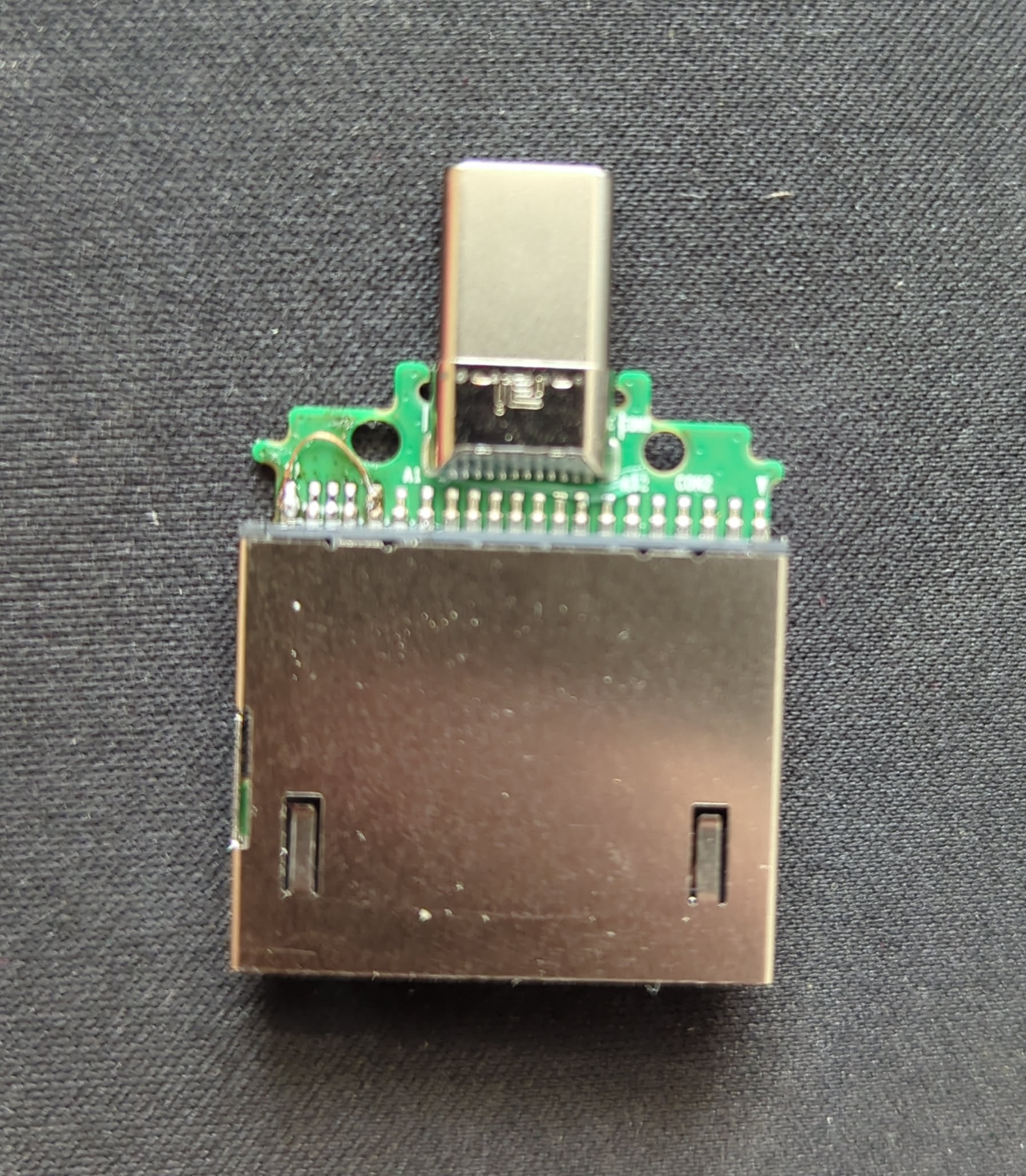

Hi all,
While testing half-length SD cards (so they don’t stick out of the expansion card), I broke the write-protect switch in my SD Expansion Card. Being cheap and lazy, I fixed it instead of replacing it.
Comparing it to a SanDisk UHS-II reader, I found the WP switch pins on the 21-pin socket. Shorting pin 21 to pin 17 makes the reader always treat the card as writable, like a microSD. Card Detect is a separate switch, so this shouldn’t affect power consumption.
Check the pins with a multimeter before shorting anything. Also note that the lock slider on your cards will be ignored afterwards.
