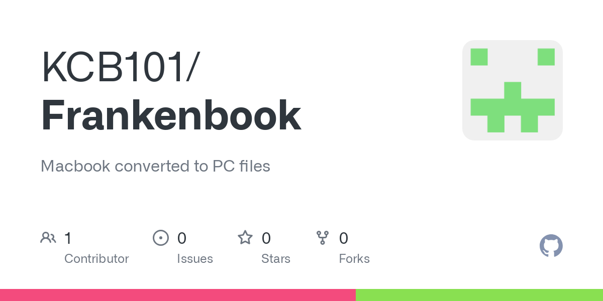

Ive uploaded the designfiles and some pictures of the pcbs to github:
