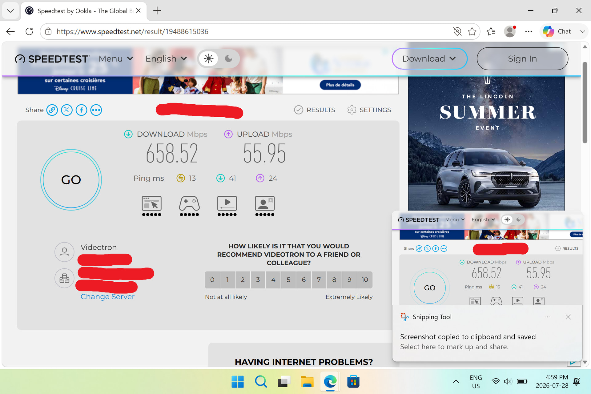

I actually had a windows pc lying around. I put windows to go on my microsd card and, unfortunately, the results are incredible!
So, that is quite odd… Also, I’m not close to my other big tower pc with linux on it so I can’t really test it out.
I think I need to figure out why I get environment bogus on linux. That might be the issue.
Well that confirms the hw is good, mid 600s to low 700s is about what I got on my old 80mhz only ap so that is good (asuming the slow upload is your internet).

The phone gets 600ish mbit and so does the laptop with the ax210 on windows which is in the expected range for 80Mhz wifi6.
