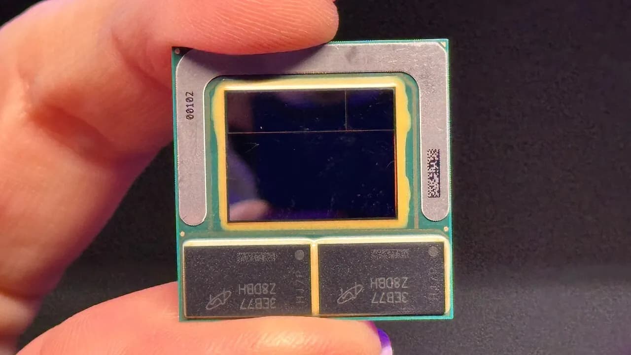

Lunar Lake has on package memory. That means that the ram is soldered onto the CPU (right next to the die) from Intel.

According to Micron, LPCAMM2 at 6400 MT/s consumes under 150 mW per 2 GB chip under full load and under 20 mW while active but not under load. Assuming 32 GB that would be 2.4 W under full load and 0.32 W when active but not under load.
With many computer components power draw increases mostly linearly with frequency as long as voltage is constant. Assuming that applies to ram then the 8500 MT/s that Intel is using would be around 3.2 W under full load in LPCAMM2 form factor. The 0.32 W number wouldn’t change as laptop CPUs reduce the ram frequency when not under heavy load.
Intel claims a 40% savings by using on package ram, which would mean the reduction should be 1.28 W under full load and 0.128 W when active but not under load.
That means that when active but not under load the on package memory only reduces battery drain by ~0.2% per hour. When the ram is under full load the savings increase to ~2% per hour, however any load that runs the ram at 100% probably also runs the CPU and other components at high enough power that the ram power draw is still not meaningful by comparison.
