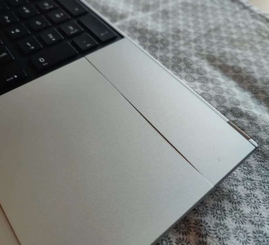

Hey Igby, can you share pictures of your spacers, unless you have already replaced them?
Currently I have both spacers on the right; here’s what that looks like:
And this is the left edge of the touchpad module:
If I move the touchpad to the middle, this is what the left spacer looks like:
If the spacers are locked in properly with their slots, I’d guess the midplate is not screwed down correctly. This doesn’t look like the spacers are bent. If you unlock the spacers and pull them back approx. 6mm (1/4""), the magnet will try to pull them back in. In my case, I’ve got to push it another mm and then the lock can be engaged.
Is the bottom left edge of your keyboard recessed (->ok) or is it flush with the frame (-> too high)?
The cracks between the spacers reach out and grab my arm hairs. Ouch! I have both spacers on the right side, and there is maybe 0.3 mm of play on both left outer corners, no play on the right outer corners, and considerable flex (maybe up to a millimeter) on the inner corners (where the spacers overlap the numpad). It does seem as though the spacers are warped a little, as their uneven lie on the chassis is obvious when looking straight on at the front edge of the Laptop 16.
I can tolerate the rough edges and hair yanking, but I will admit that this is my least favorite design element of the Laptop 16. The crack between the alphanumeric keyboard module and the numeric keypad module is totally acceptable, given the modular flexibility of the system, but the cracks between the spacers, where my right arm rests while typing, are uncomfortable and give the machine a “hacked together” look (though maybe some folks enjoy that aesthetic).
I put a piece of electrical tape on the midplate under the seam between the keyboard and keypad and it disappeared. Highly recommended easy mod for anyone concerned with aesthetics.
Everything is locked in properly and I’ve checked and rechecked all the midplate screws.
That about describes my experience too.
Recessed all around.
The photos probably make it look worse than it is. The amount that the spacers/touchpad module sit proud of the top of the laptop is only about the thickness of the aluminium sheet. I only posted these photos because Destroya asked me to, I’m not trying to say I have an exceptionally bad case here. I don’t have the arm hair pulling issue so really it’s just aesthetics (and the way that affects the perception of quality). But aesthetics are important for some people, especially when we pay a lot for a product.
Thanks for sharing the pictures @Igby ! I asked for the pictures because I’m trying to understand of the spacers/edge of the touchpad caused the mark on the bezel, we haven’t seen anything like this before.
please check if the mid plate is seated correctly and the 16 screws are tightened evenly and fully, this should solve the issue. Since you see this “bump” on one side only and both with the spacer module and the touchpad, I’m assuming the issue is with the mid plate / seating instead of the modules. Please let me know if the issue is solved after reseating the mid plate.

I had already checked the midplate screws, but I did go ahead and completely unscrew and reseat the midplate again. In the process I did discover one interesting (and disappointing) fact, which is that most of the speaker screws rotate with almost no resistance, i.e. threaded posts in the bottom enclosure that receive these screws are stripped, and came to me this way. The reason I checked this was to see if the speakers were seated correctly. If the speakers aren’t fully seated, my theory was they would be pushing up on the midplate which in turn is pushing up on the corner of the touchpad module.
I was able to push down on the left speaker and get it to sit lower, but to be honest this was inconclusive and it’s not clear whether it stayed down or popped back up, nor is it clear whether it pushes up the midplate.
What I can say is that I can push down on the midplate in this area and it moves down significantly when I do so (and then springs back).
This is the area I’m talking about. There are no midplate screws near enough to my finger to hold this zone down:
I believe if there was a screw holding down the midplate here, then the corner of the touchpad module (or spacer) would be able to sit flush with the enclosure.
As a result of reseating the midplate, I believe I got a faction of a millimetre of improvement, but it’s not significant.
Before:
After:
(I have the lid propped open in those shots)
