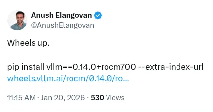

for vllm there is a new build:
# in a venv ;)
pip install vllm==0.14.0+rocm700 --extra-index-url https://wheels.vllm.ai/rocm/0.14.0/rocm700
Note: did not test, I never have use vllm so not sure to know if it work :wink:
