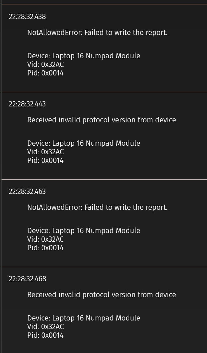

Thanks again for your help, I have clicked on the link and authorized it access. I can see two numpads, I tested which keys of the keyboard responded to input in case it helps: the fn key opens the calculator , the \ key opens the calculator and responds as backspace and escape, the f9 and f12 keys respond as the equal and plus key next to the backspace, the M, Z, C, E, O, -, keys turns off the backlight, the c key toggles it on and off at low brightness and the Q key turns on the backlight at max brightness.
I can change the backlight brightness on the website, but that’s pretty much all that I can do.

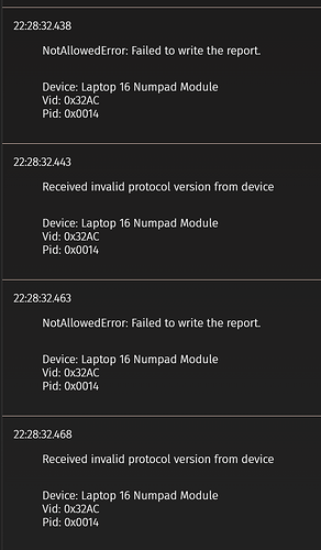

disconnecting the numpad also disconnects my keyboard, here is a screenshot of the error messages displayed:
