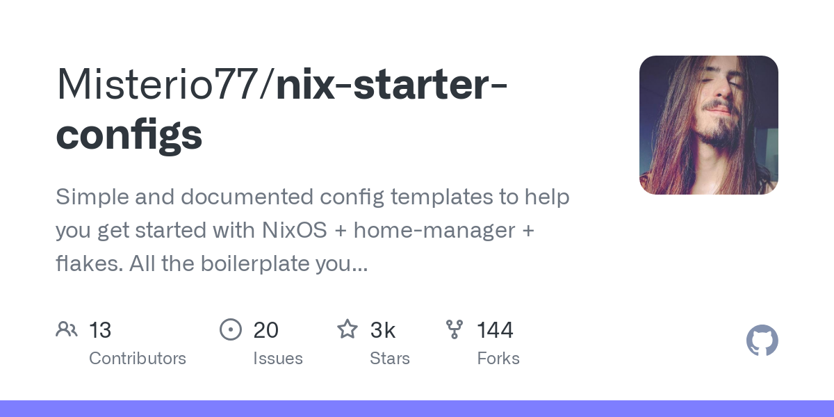

If you don’t know where to start or how to structure your config files, it might be worth checking out this repo for some inspiration
