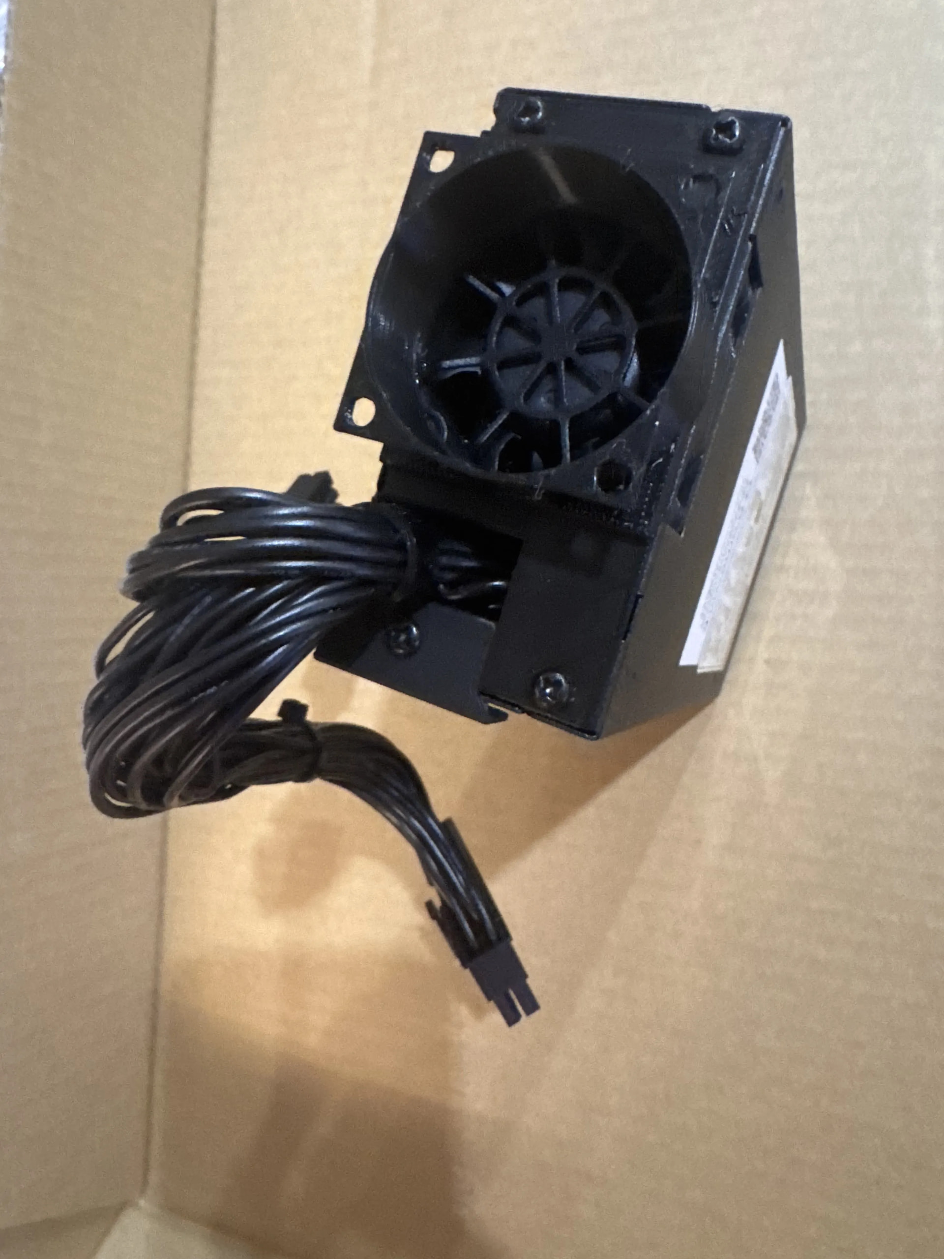

Btw, did anyone who received a new PSU take apart their old one to see if there isn’t something obviously wrong with it, and which might be a relatively easy/cheap fix? Maybe something was not mounted properly? Or just like changing the fan to make it better, or completely fix it?
I was reading this post, where people reported high temps and communicated back and forth with support for weeks, while the issue was that the foil between the heatsink and the chip was not taken off… High temperatures, am I doing something wrong? - #22 by NOXI
Unless you are trained in the field I would never touch the internals of a PSU. You risk being electrocuted or creating a fire hazard by changing stuff.
The internals of the PSU are most likely produced by FSP and not touched by the OEM assembling the Desktop. FSP is a huge producer of PSUs and messing up stuff like that would be a safety critical issue which I doubt is the case. The used fan is from Delta and I doubt you’ll get much more powerful 40 mm fans. To reduce the noise one would need to use a weaker fan but apparently those are not sufficient, probably because the internals are fairly packed.
On the other side, there appear to be issues with the fan control of the PSU fan, as we had reports where the fan never kicks in, while the PSU is getting hot. On the other side there are units with only on/off controls, unlike the gradual speed control that Framework advertised.

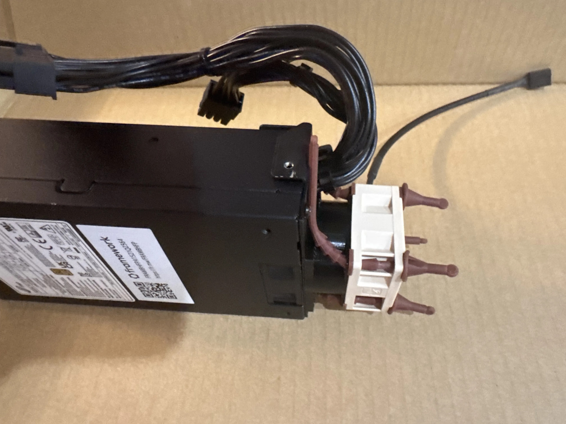

There is room at the front of the PSU and USB cables for a very small fan. I don’t know if anyone has tried that. Sunon make a range which included quiet PWM ones which, if I had the case, would be what I’d try
This would be something worth trying, to remove the PSU duct and install a small front fan there, maybe even a 60mm could fit.
TBH I think the space would be closer to 30mm … hence the Sunon suggestion
I wasn’t suggesting that although it’s also an option. I was pointing to the space at the very front of the case

I 3D printed an adapter to attach a Noctua FAN inside. I had a couple of failed tries before it finally fit.
https://makerworld.com/en/models/2080451-framework-desktop-noctua-nf-a4x20-adapter?from=search#profileId-2248000
If there is a demand I could put it into a webshop or something
That length is needed to bridge over the 2 USB-C front connectors
