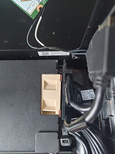

I ended up switching the fan of the PSU to a Noctua A4-10
No particular issue, it fits well and I didn’t have to butcher the PSU enclosure, there’s just a longer cable.
However I don’t really know if this is working, so I probably wouldn’t recommend doing this unless you know exactly what you are doing. I can’t hear the PSU fan anymore but I don’t really have a way to monitor how much the fan is spinning (if it is spinning at all) or if the PSU is overheating. It doesn’t seem worse than before when I touch it and the computer is working fine even under load. If I have some time I’ll try removing the PSU air duct to see if I can watch the fan spinning or something.
Again, I did this because I thought it’d be a fun solution and I’m fine with replacing my PSU if I ended up breaking it, I wouldn’t recommend it for everyone.
I followed this guide: https://youtu.be/YhFbd5NMGz4

I notice on your picture there seems to be a little free space (depth) just behind your fan = do you think a thicker fan like the NF-A4x20 could fit ?

For the fan, a post above did mention the A4x20 but said it didn’t fit well, which is why I picked the thinner A4x10
I should add that since my post I’ve tested that the fan does spin when connected to a 5V power source so I didn’t f up my wiring with the Scotchlok connectors. I’ve removed the air duct to be able to actually watch the fan and see if it spin or not and I have yet to see it spinning. So yeah. Either I somehow broke the fan connector of the PSU - but I assume I’d have way more PSU overheating issues under load than what I see right now, or it spins silently when I don’t see it. Or the front fan that I have added at the same time provides more airflow and cools down the case interior enough. I don’t know. At this point I don’t think I’ll tinker more with this PSU, either Framework comes up with a better PSU or I’ll end up replacing it completely by something like the FSP you mentioned at some point. Thanks for the tip!
UPDATE: after a bunch of stress tests and looking closely with the air duct off, the PSU fan does spin! it’s just completely silent. So yay! I didn’t break my PSU. Maybe I’ll put the air duct back at some point (I’m kind of dreading the idea of tearing apart this computer a FOURTH TIME for this but I guess I’ve had it coming)

I was actually taking the computer apart to make a hole for the Oculink cable, so I decided to snap a photo. If anyone wants to know what an NF-A4x20 looks like when it doesn’t fit — but how quiet it is instead.
I think PaulM did it better.
