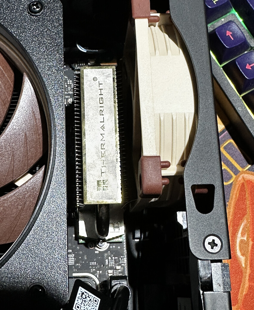

NVME cooler
If anyone was wondering, yes, a Thermalright HR-09 will fit.
I notice you added a 2nd Noctua, which one did you order, and from where?
Also, do you happen to have any before (Framework’s included thermal pad/lid) and after (HR-09) temperature measurements of your M.2 NVMe drive at idle, and/or under load?
Its the 80mm NF-A8 PWM. Got it from Amazon. I don’t have any measurements right now. I got this heatsink because I installed a Micron 7450 Pro for a ceph cluster. The drive idles at 40C with the heatsink on.
Very helpful, thank you!
