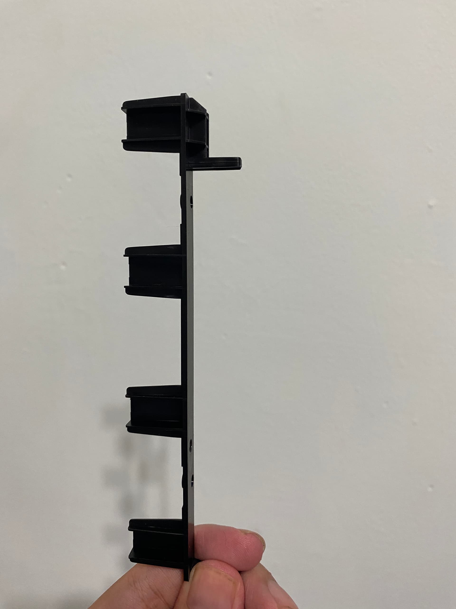

Plastic Standoff Interference with Rear Exhaust Fan in Standard ATX Case
When mounting the AMD AI Max mainboard in a standard ATX chassis, the plastic supporting standoff/bracket on the I/O side physically interferes with the rear exhaust fan. With a standard 25 mm-thick fan, the fan frame collide with the CPU heatsink, preventing installation. In my configuration, the only way to make the rear position usable was to switch to a 15 mm slim fan and remove the plastic bracket entirely.
