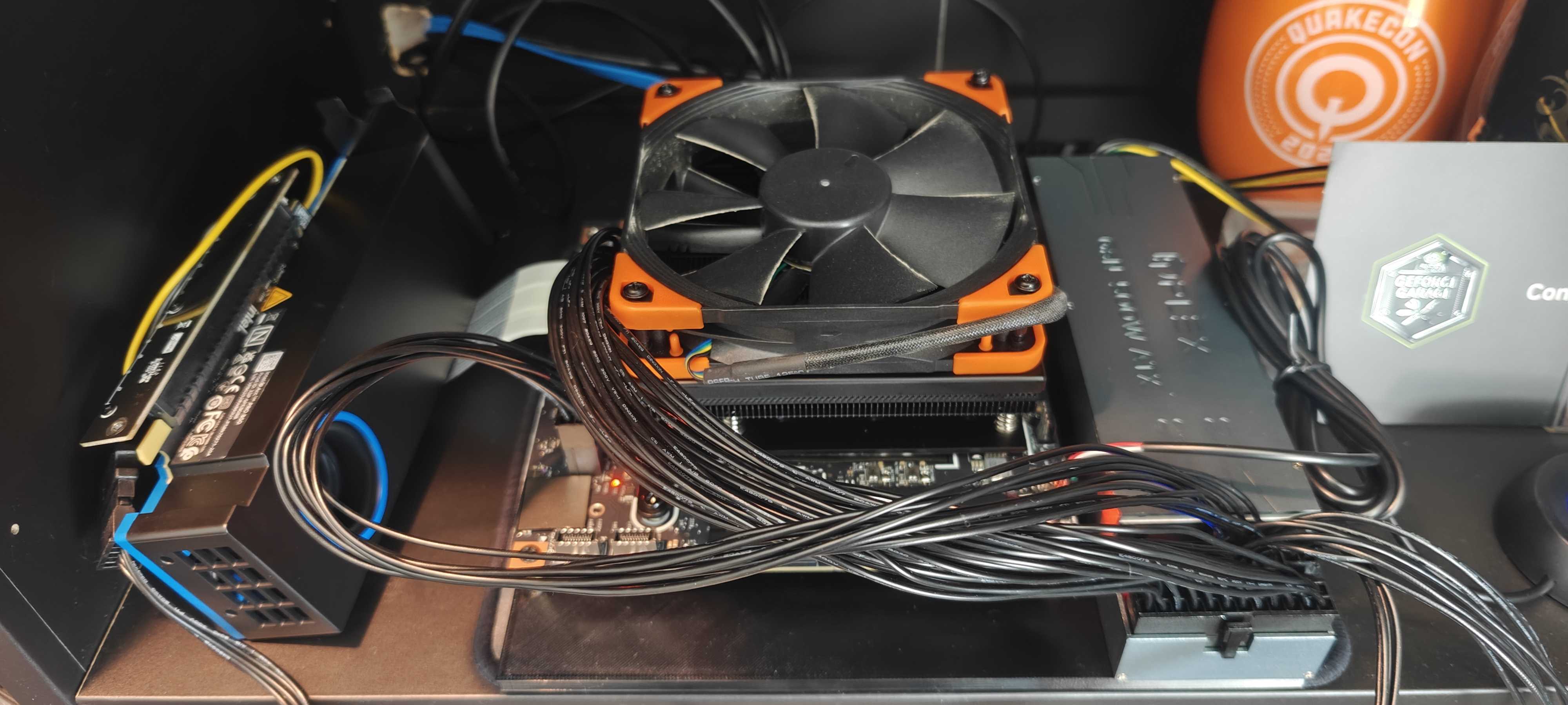

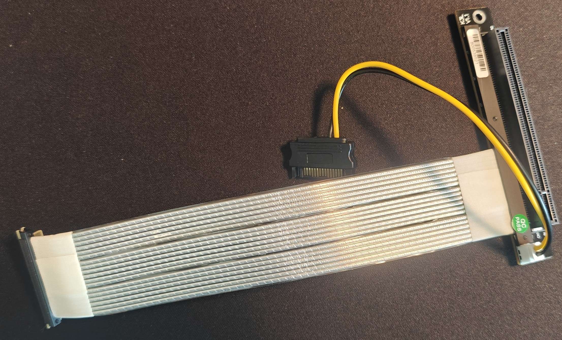

So my riser finally came in
And I picked up the Intel Arc B50 Pro
I Frankenstein-ed my set up back together, I’ve been working on a custom cold plate.
And it looks like it’s just working happily
I’m about to grab my other monitor and plug it into the intel card and test some more stuff like under load and whatnot. But I was just so excited because I believe that terminal output means that even resize-bar is working.
Annnnndddd: I don’t have a mini display port cable or adapter…
I got my mini display port adapter in and it works just fine. In playing around for a few hours I couldn’t get steam on linux to use the dgpu over the igpu to load test it… but with the display coming out of the dgpu it was able to game off the igpu which was a neat trick, event if it’s not what I wanted at the time. Other quirk is that somehow having the dgpu installed has made the system very mildly unstable, if I leave the computer alone long enough for it to go to sleep I instead come back to a wall of fullscreen terminal error text. (I’m testing on cachyOS right now)
So aside from the mild instability, it “seems” to be working? I need to play with it more and make sure the gpu can be fully loaded up happily. Also the reason I got the gpu was not to use it for gaming, I bought it for SR-IOV for virtual machines… which that feature for the card is so new that the only people that have it working got it working “early” so… hoping that soon official support hits and guides appear.
To be clear my usability goal is to use the igpu for everything on the host, and to just have really strong virtual machine performance with the 16 cores and being able to pass through chunks of the dgpu. (I regularly use CAD and old adobe applications, but those don’t play nice on linux even with wine, so I run them in a VM but that VM needs gpu acceleration to be smooth)

hi. would you mind providing a link for the raise please
depends on which model you want: https://www.adt.link/x4.html

Also passed the intel arc b50 pro through to a windows VM went to install drivers and it decided it needed the new firmware… hopefully that will add to the stability…
I also found before adding the kernel parameter and before updating the firmware that it only liked to crash with a monitor plugged in. So let me spend some time fiddling with it and see if I can get it to crash again…
So not sure why but even before tinkering with things today I did have it crash twice if a monitor was plugged into the intel card… But I added the kernel parameter anyways… it still crashes randomly with a display plugged into it on the host…
but unplug the monitor, boot the host, configure the VM with it passed through, then run the vm…
Resizebar confirmed:
and I can even load it up fully with a game in the VM with no issues
My guess is that the card has some kind of driver bug with my kernel/firmware/whatever on cachyOS, but I can at least confirm that everything works with the GPU running on the framework motherboard, nothing fancy needed… just a Adt-Link riser that has power injection.
