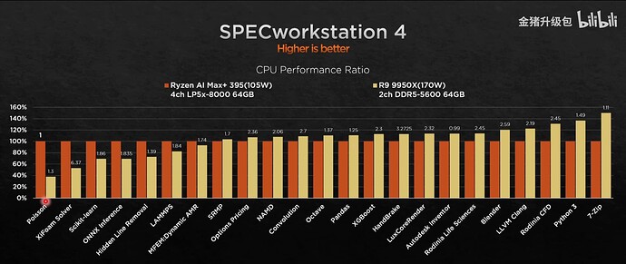

Thanks for the benchmarks! I think actually your watt reading is probably incorrect, because those results are in line of what one would expect, and they are definitely multithreaded.
It puts this CPU between the 9900x and the 9950x, which is also somewhat expected. I had hoped it would be closer to the 9950x, but here we are. Not a bad result in any case - my outgoing ThreadRipper 2950x (also 16-core) scores less than half!
The memory mark rate needs further review indeed. For comparison, my quad-channel TR hits 2059, while I’ve found a benchmark for the 9950x with 96GB @ 6000 hitting 4256. I wonder if we’ll hit significantly different speeds (and particularly latencies) with different manufacturers… or are they all using the same RAM ? One needs to keep in mind 128gb is not attainable at these speeds on a 9950x (yet).

Yeah, it’s under our expectation… I posted this in my above reply.
AFAIK, the weakness of AI Max memory is high latency, and the CPU part’s read performance is less than we thought (but still powerful), only about 120 GB/s (because each CCX memory read is 32 B/cycle, which is about 60GB/s in 2 GHz FCLK).
However, the memory bandwidth-sensitive benchmarks are far better than 9950X.
