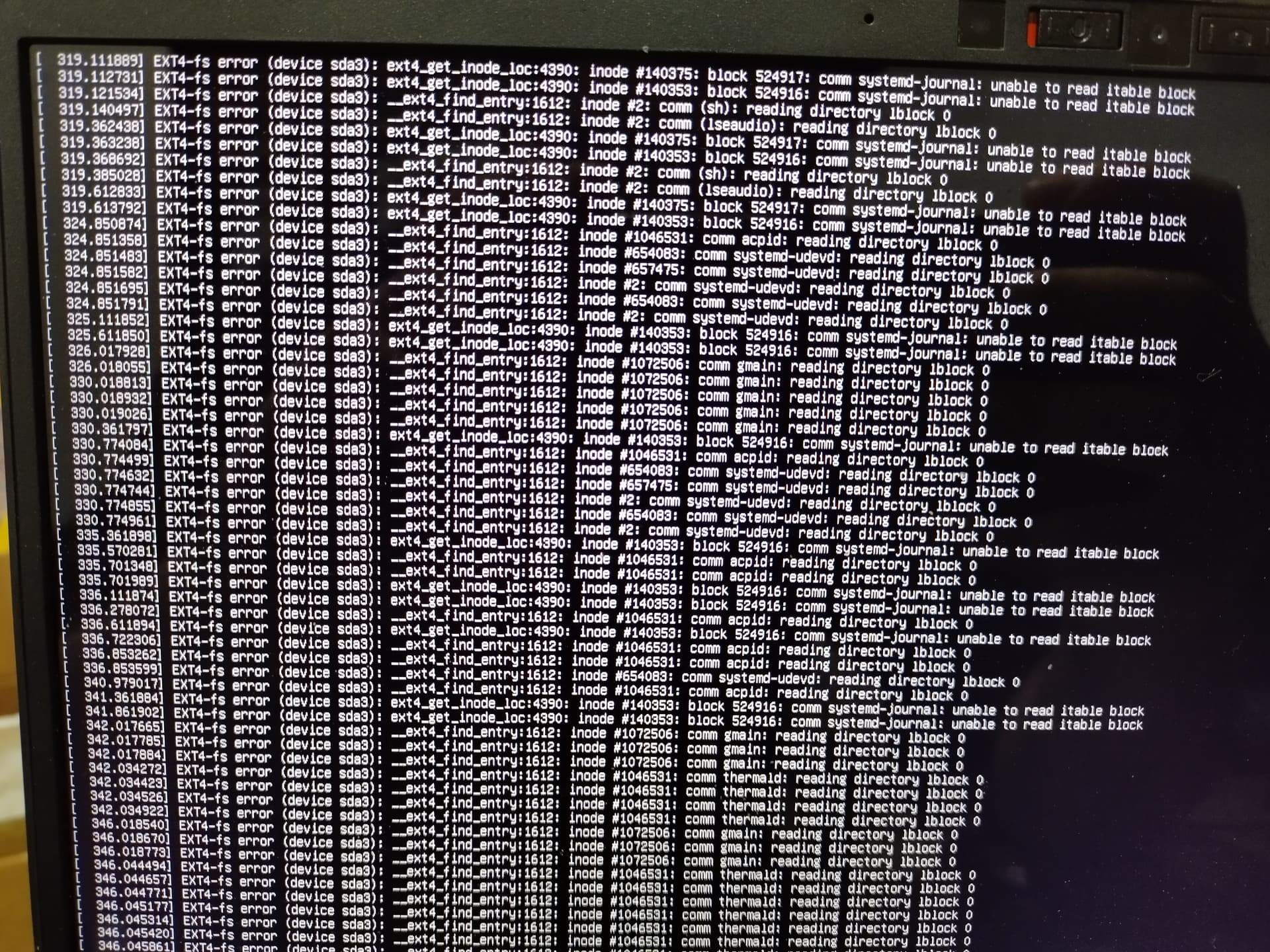

With the reports of 3.09 “fixing” this, I tried with the install that was doing this regularly. Logged in, updated the OS, and started updating some games for the screen to go blank and start throwing the disconnect, and read only errors.
I’ve re-installed the OS, and have started to perform the use case described in my previous reply to see if it was a situation of once borked, always borked. Hoping that the BIOS update ‘did’ fix this, but not holding my breath considering the inability to reproduce for the manufacturing partners.
As an update, this BIOS update has not solved the issue for me. Error happened quicker than I am used to it doing so. Same as previous, Lockup of GUI, Dump to Terminal, spam errors onto the screen.
Edit: For context sda3 is my root partition.

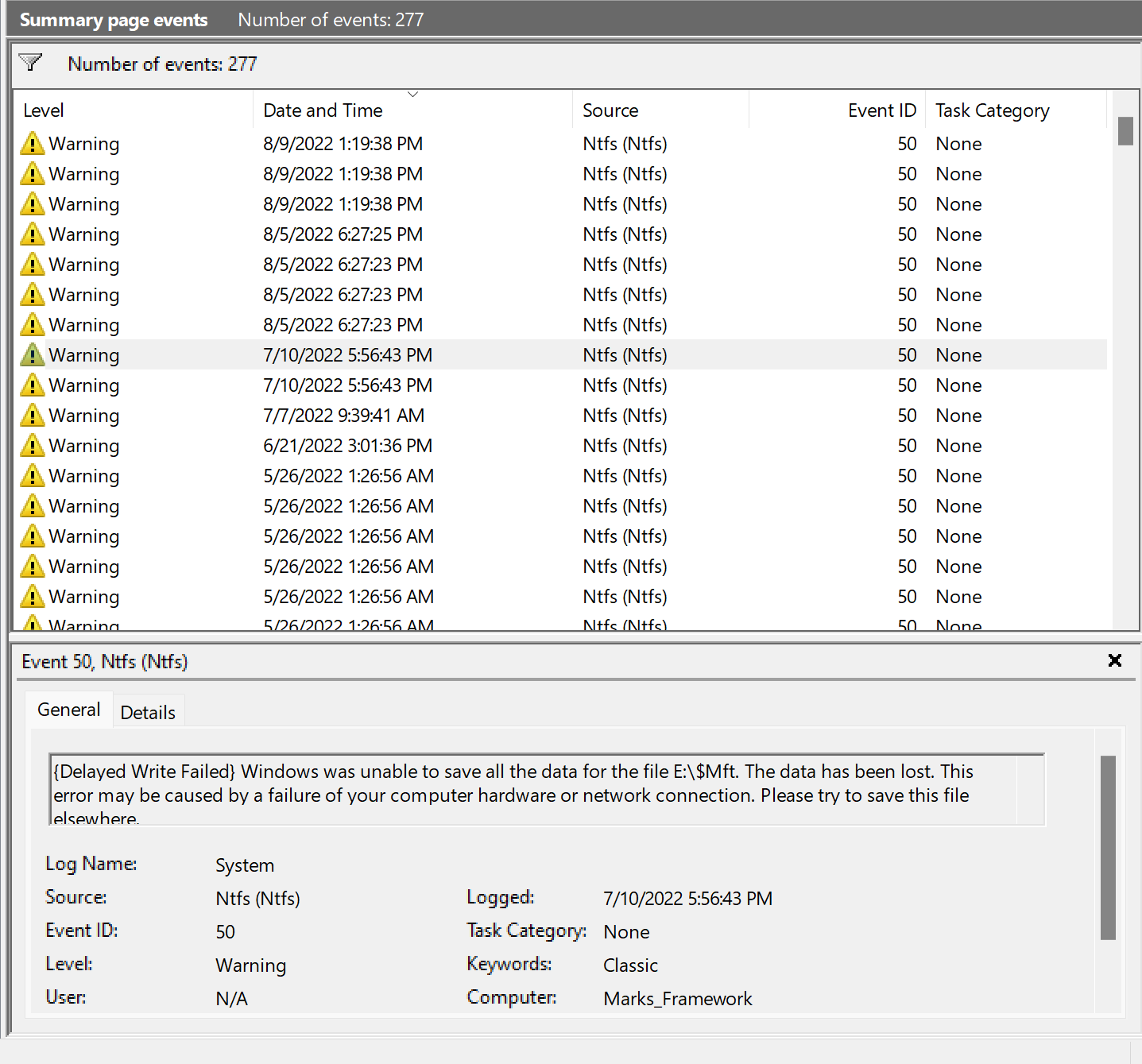

@Ironsidemaster I mentioned this earlier in the thread, but I had a lot of “Delayed Write Failed” errors until I disabled the Windows “Quick Removal” option for my 1 TB expansion card.
Since that change, I’ve only had 3 disconnects. And none since May 19th. I know other people have said this option hasn’t helped them. But it’s worth a try!

It seems a little more subtle than that. I’m not noticing the drive disconnecting (i.e. no popups complaining that the drive disconnected), so my theory is that sometimes there’s a problem writing to the drive that would exceed a timeout, but with the cache enabled, it doesn’t cause the Windows error.
As for the root cause, you’re right. I haven’t heard anything official, though I think it might be less a problem with the drive and more something quirky with the USB ports.
I think so too, and it could also be why it’s not realised by the OS as a full disconnect. From the OS’s perspective, the drive/device is still connected…but for whatever reason, it’s not able to fulfill the various write requests at certain times.
