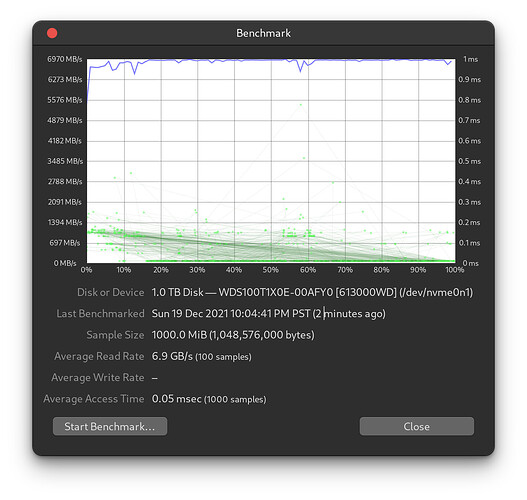

My 7000 MB/s drive craps out at 900 MB/s with LUKS. All the NVMe advantage goes to trash. Could have gotten those speeds with SATA.
I’m wondering if I use an unencrypted Ubuntu install with a BIOS-set HDD password on a Samsung 980 Pro actually encrypts the drive properly. If so that would probably be much better performance.
This seems pretty accurate. Just ran some read-only benchmarks:
I read your last comments a little confused. I encrypted root and I am booting way quicker than 20 seconds until login screen, more like 2-4, at most. I don’t think your speed problems are as black and white as encryption yes/no. There’s something else cooking.
