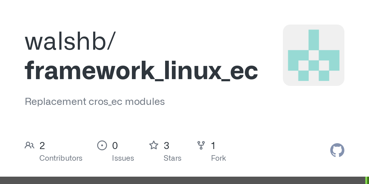

It has, by @jubnut, for kernel 6.11+
@Nine_Mile Kernel 6.11 will be released this month, but in the meantime you can use the prototype version of my kernel patches:
