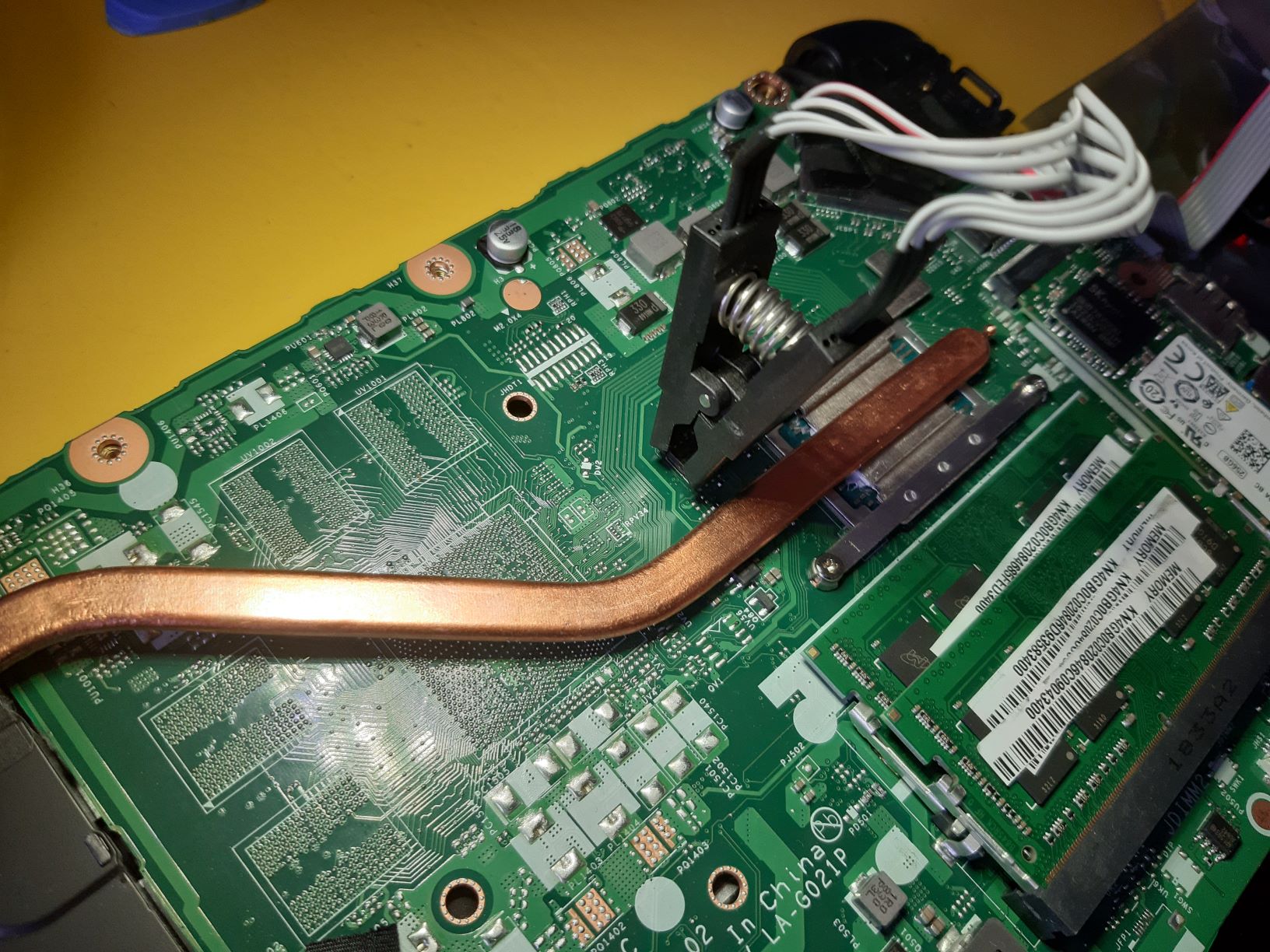

Not exactly, if SPI controller is supported by flashing tool e.g. flashrom one can hot swap chips. It would work as follows:
  • boot your platform to OS with functional BIOS storage
  • while system booted remove BIOS storage
  • place second chip (spare one) in socket
  • flash development/debug version of coreboot/BIOS/UEFI
  • reboot the platform and gather logs
  • modify you coreboot/BIOS/UEFI code and repeat until you get working firmware
I will teach that technique in free OST2 training called Architecture 4032: coreboot Hands-On
Interesting, so far i used a eeprom programer with a SOIC-CLIP for flashing. It has the upside that it ignores the flashing protection that most laptops have and you can always reflash a corrupted bios. Its a rather dangerous method though since using the wrong programing voltage will destroy the chip. Trying to create a somewhat working coreboot image is definetly something i might try in the future even though i still lack a lot of experience and knowladge on this topic
Yeah, you are right this is one of the most popular methods while developing or modding firmware. What Iā€™m saying is that there are different methods and not all of them make sense for all hardware. Clipping hundreds of time a day, while you develop/debug coreboot or other Open Source Firmware can be really annoying and eventually can destroy something. coreboot developers in some situation repalce the chip with socket and make it swappable, what gives ability to hot swap, of course if you can leverage SPI controller. Some intresting notes can be found on old coreboot wiki
