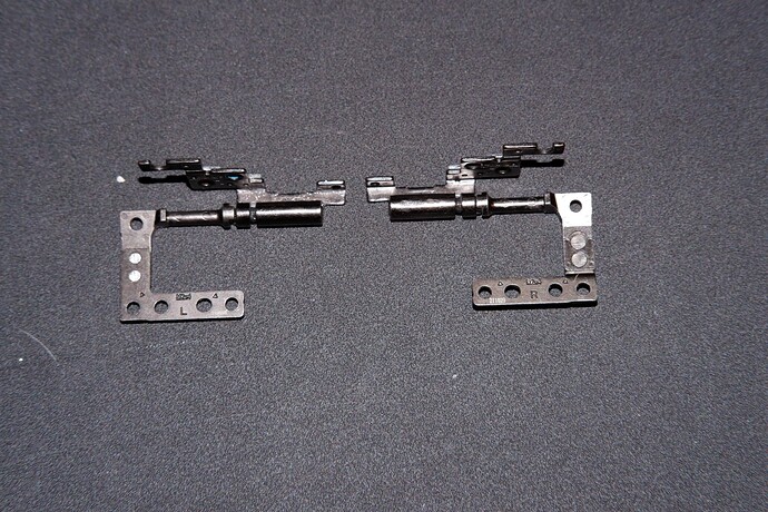

I just received word from Framework support that they’ll make an exception and send me another replacement 3.3kg hinge kit. They’ll also be sending me a shipping label so I can return my defective hinges to them for review.
While I’m fairly disappointed with the experience so far, I want Framework to succeed, and I want Framework to continue to put pressure on other companies to do better in terms of repairability. So if this third set lasts, I’ll be more than happy to start recommending Framework again.
I’m not really concerned about the 3.3kg vs 4.0kg difference anymore. My friend’s Framework doesn’t have any issues with screen movement on stock hinges. So unless they prematurely wear out again, I’m fine with 3.3kg. I do agree with @Usernames, it feels unnecessary that they wouldn’t offer the 4.0kg as a gesture of good will since the cost to Framework is the same. But all I really want are hinges that will keep the screen in place while stationary and typing.

I received the new replacement hinges yeterday, and just installed them. With the new hinges, the screen does once again hold itself in place at any angle, as expected.
I still think it’s a little looser than I would hope as you approach 180, but should pose no usability issues during light usage. I would consider this to be within spec given Framework has prioritized one-handed opening over stability for their out of the box experience.
As for the defective hinges that I removed.
The right hinge feels perfectly sturdy. It is pretty difficult to turn by hand, and has uniform stiffness. Feels perfect.
The left hinge however provides almost no resistance. Also, looking closely, it looks like there’s a lot of goop seeping out of the sides of the hinge, which I suspect is lubricant leakage? I’m guessing these hinges are supposed to be sealed with lubricant to prevent metal on metal wear. And with that lubricant leaked out, the hinge pre-maturely failed.
I’ll be sending the hinges back to Framework for review, but I’ll also post this photo here. It would be interesting to know if other users with bad hinges also found this lubricant leakage.
Interestingly I noticed that my left hinge was noticeably “lighter” than the right hinge, didn’t have a the lubricant leakage you described though. Might be that there were some bad LHS hinges in the mix. I noted FW rate the hinges for 20,000 cycles so unless you are opening and closing the lid every 20 minutes for 16 hrs a day they should last more than a year!
It was similar with my first defective set. One hinge felt good and the other one was very weak. But unfortunately I threw out that set after installing the first replacement set. So I can’t confirm if it was the left hinge in that case as well.
Third set of hinges is starting to have the same problem. It’s still stable at most angles, and isn’t much of a hinderance. But the screen will fall under its own weight if you put it past around a 150 degree angle.
My laptop is well out of warranty now. And when I received my second replacement set, I was refused the 4kg hinge. So I really don’t see any point even trying to reach out to support again. The 3.3kg hinge is defective by design.
