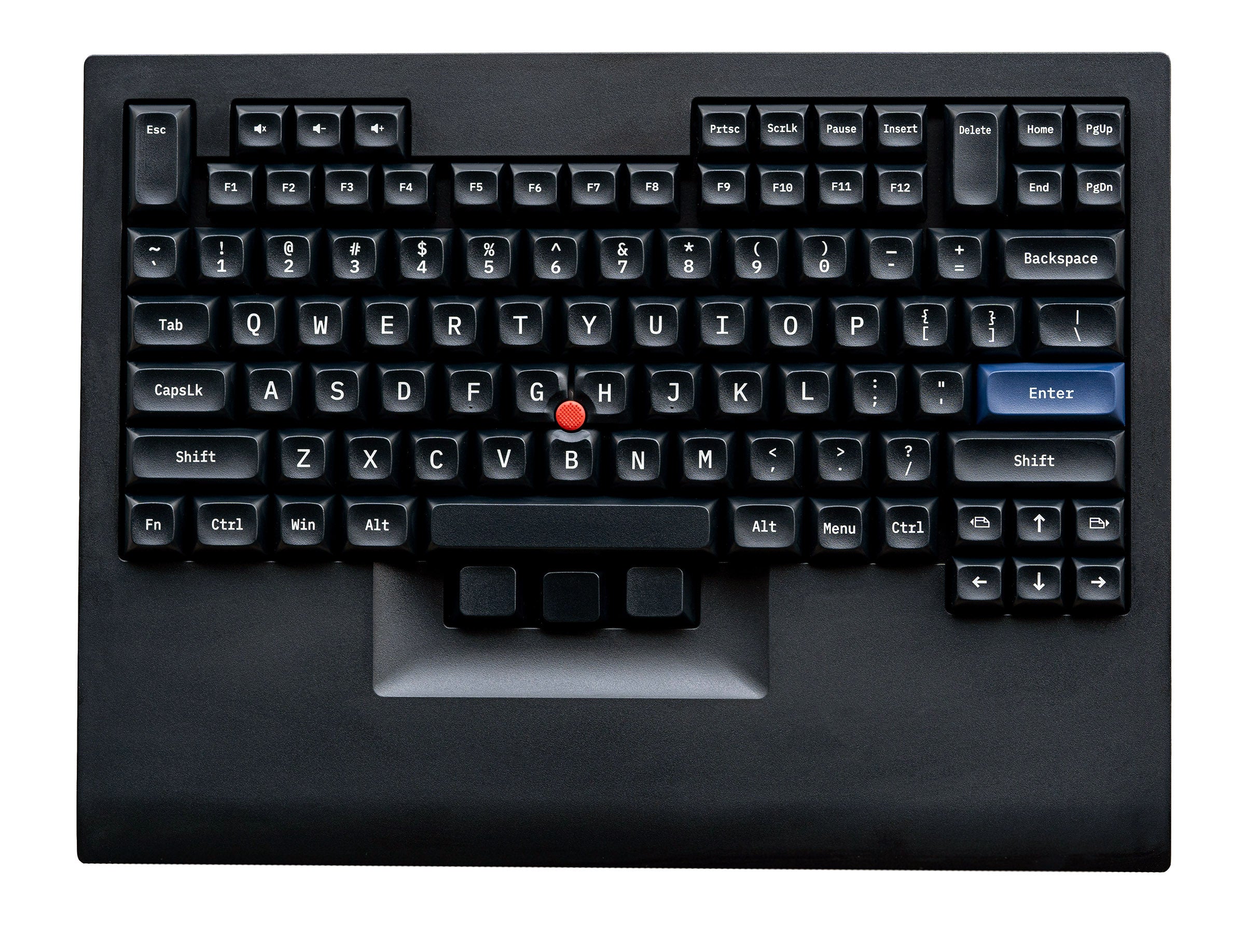

Right now I’m just carrying a Tex Shinobi with me and setting that on top of the laptop keyboard to work. If that’s a bit large for people, the lenovo thinpad compact USB keyboard or the Happy Hacking Studio Charcoal that came out recently could work.
