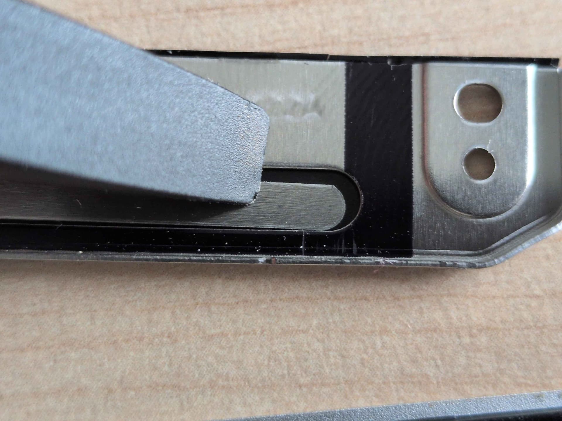

diassembled the touchpad and found that this piece of metal under the touchpad was incorrectly aligned
Small addendum:
while the above fixed the extra clicking/cracking it was only part of the problem, the area circled in red had some sort of residue that stuck to the touchpad that was not on the other side.
Cleaning it with isopropyl alcohol and a cotton swab solved that issue and resolved this completely.
