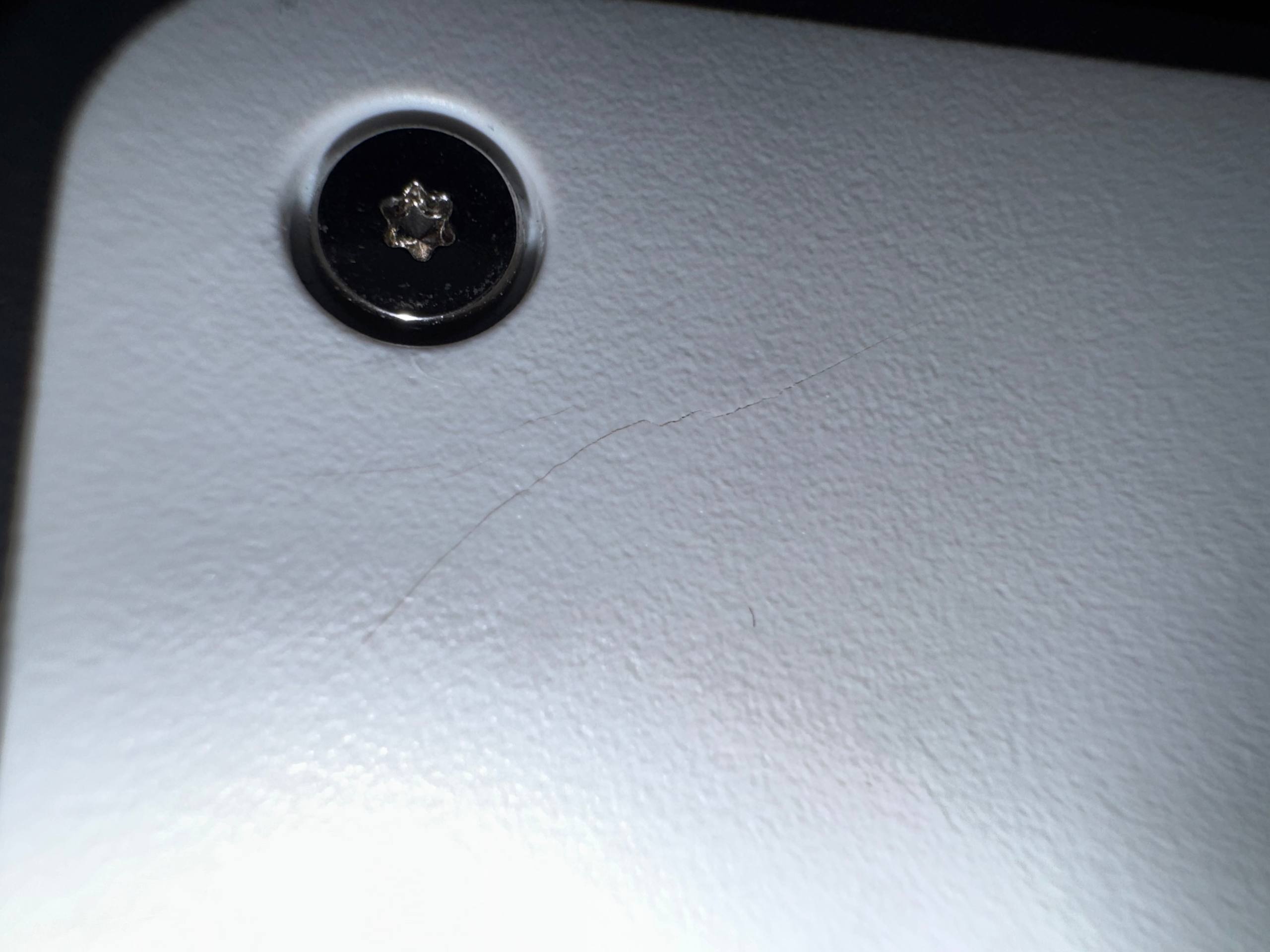

It looks like my chassis is developing these cracks, too, which is a major bummer. I just received my Framework 12 on the 1st of this month (August), it hasn’t even been a full week yet! I’m absolutely certain I haven’t overtorqued these screws, as per the other thread mentions. I don’t know if somehow I got an old, bad chassis and their QA missed mine somehow or if the new, updated chassis still have this problem. Here’s to hoping my top lid doesn’t develop any cracks either, other than this issue I really love this laptop!

Well, blast. My latest Sage bottom case is starting to crack at the corner of one of the expansion ports.
Is it updated??
Support said it was the new version when they shipped it. I think it was dated in November, which is prior to the date Eagle said all colors were definitely the new version. But some colors were supposedly the new version prior to that (how much prior?). Either way, it’s starting to crack. It’s small right now, but it’s unmistakable, and now that it’s there, I’m sure it will spread fast. It’s starting right from the corner of the expansion card slot and running out at a roughly 45 degree angle, just like so many others here.
Edit: It’s only about 1/4" long right now, but once a crack starts, it tends to spread much more easily than it starts.

Let’s get a ticket opened. Ask to be escalated to me or DM me the case number once you do. We will want to capture the cover for analysis, after I check the serial number of the cover from the system.
We will get you another sent out with a label to send the one you have in.
