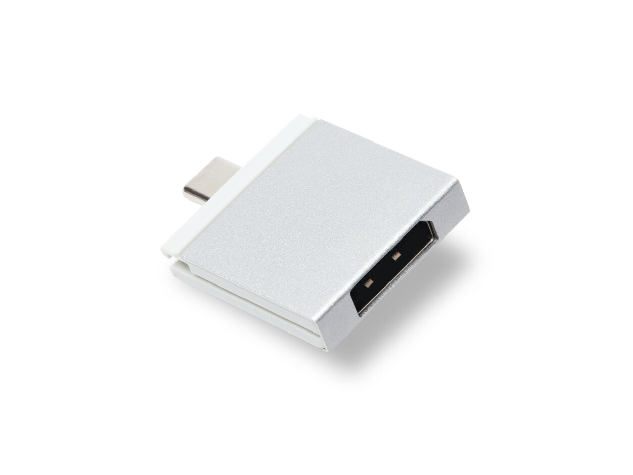

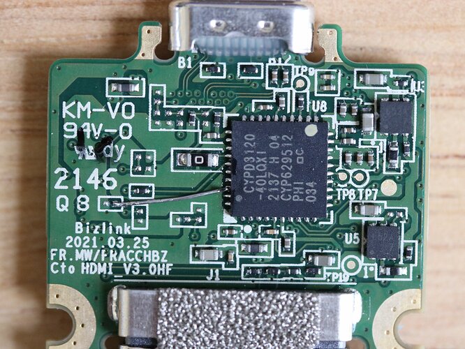

Recently i got email from frame.work that there is new firmware released for DP modules and there are new HDMI modules in production with fixed powerdrain. Does it mean that this issues with powerdrain in sleep should be solved by that?
It will help with the drain from those modules, yes.
