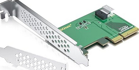

I didn’t use a direct riser cable, but a powered adapter board connected to a x4 pcie adapter using slimsas cable.
Basiacally these:
Some amazon links (not the exact ones I have, but they are mostly generic passive boards):
I already had the adapter boards, so I just needed a cable to connect them.
Could maybe also do it with mcio based boards, but I haven’t seen many of the mcio 4i cables and pcie adapter type boards that would fit in the framework desktop x4 slot.
