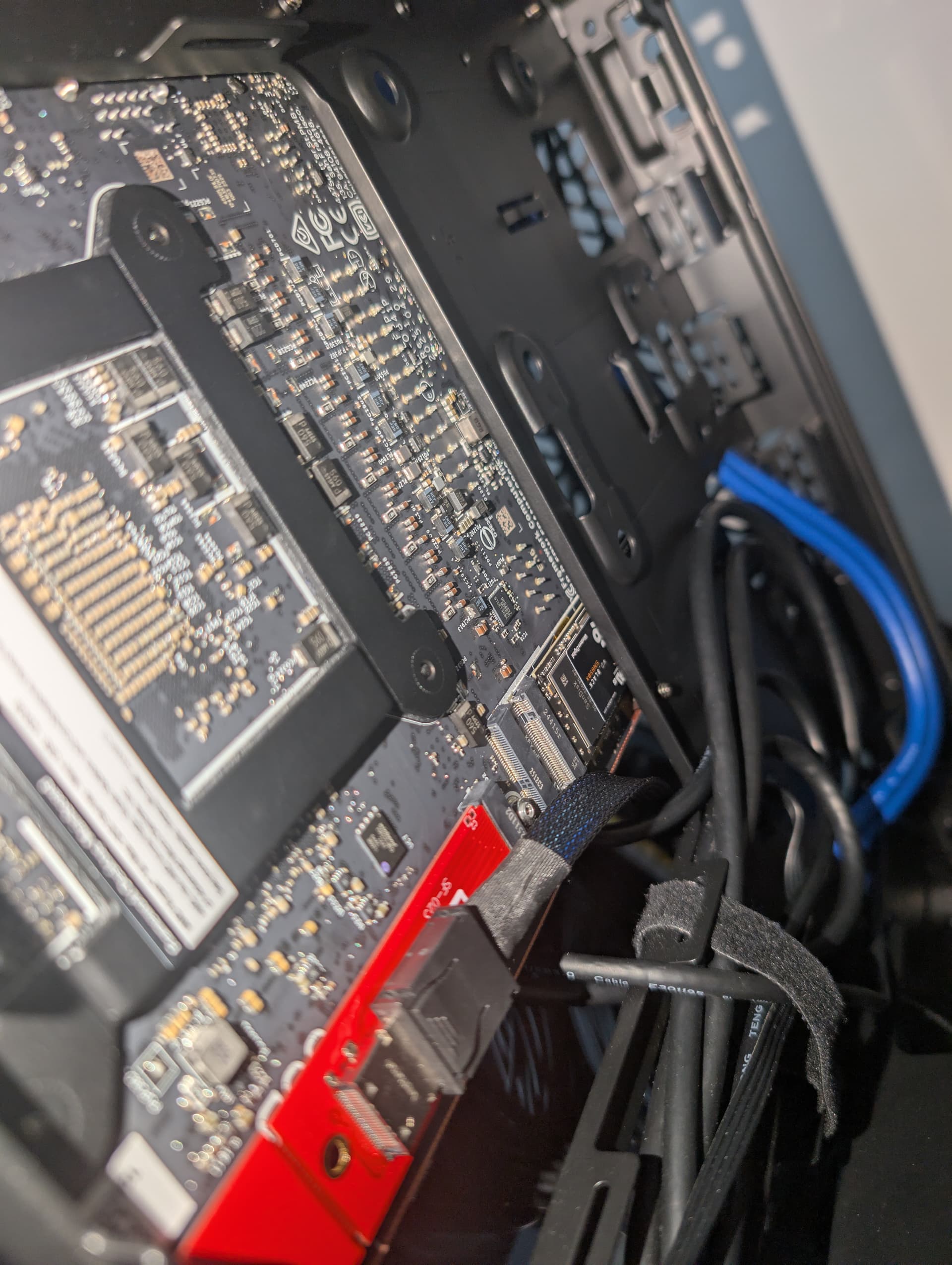

It looks to me, based on a photo in this thread, that @Frix_Rioux is running an AMD eGPU through an Oculink card

I’ll make a little update. I installed Debian Trixie and started playing around. I have an Minisforum DEG1 with a Micro SATA Cables reDriver oculink adapter and a high quality oculink cable. I tried LMStudio at first, but it have problem detecting the igpu when paired with a dgpu so I switched to llama.cpp. Pluging a Nvidia card give me no problem. For a amd card, things get weird, I have a weird delay before the bios start. When linux start I get error, timeout and sometime the cpu lock. I tried many thing for hours, in the like of powering the dpgu before or after starting the computer, witch hdmi port to use, some grub options. I did not manage to make much sense of it. It managed to boot 3 times. It feel that it take like 5 min to boot. I cannot help much as I do not understand what is going on.
Okay, I’m managing to boot consistently with my 9070 XT. I’m using x11 and gdm3 and using the amd_iommu=off grub option if that matter. Here is my method:
  1. Plug hdmi on ipgu. Power up.
  2. When it display. The kind of lag before the bios start (you only see a cursor). Unplug hdmi.
  3. Wait, possibly a couple minutes.
  4. Replug hdmi in igpu. If thing are going well, you will be at OS login screen. Somehow, the display do not turn on correctly with hdmi plugged at the end of linux boot.
  5. Log in. Screen will turn black. Plug hdmi in dgpu.
  6. Then you can plug hdmi where you want. Plugin hdmi in dgpu somehow fixed something.
Yeah, this is weird and do not make sense and it’s hard to be confident there is not something else involved.
