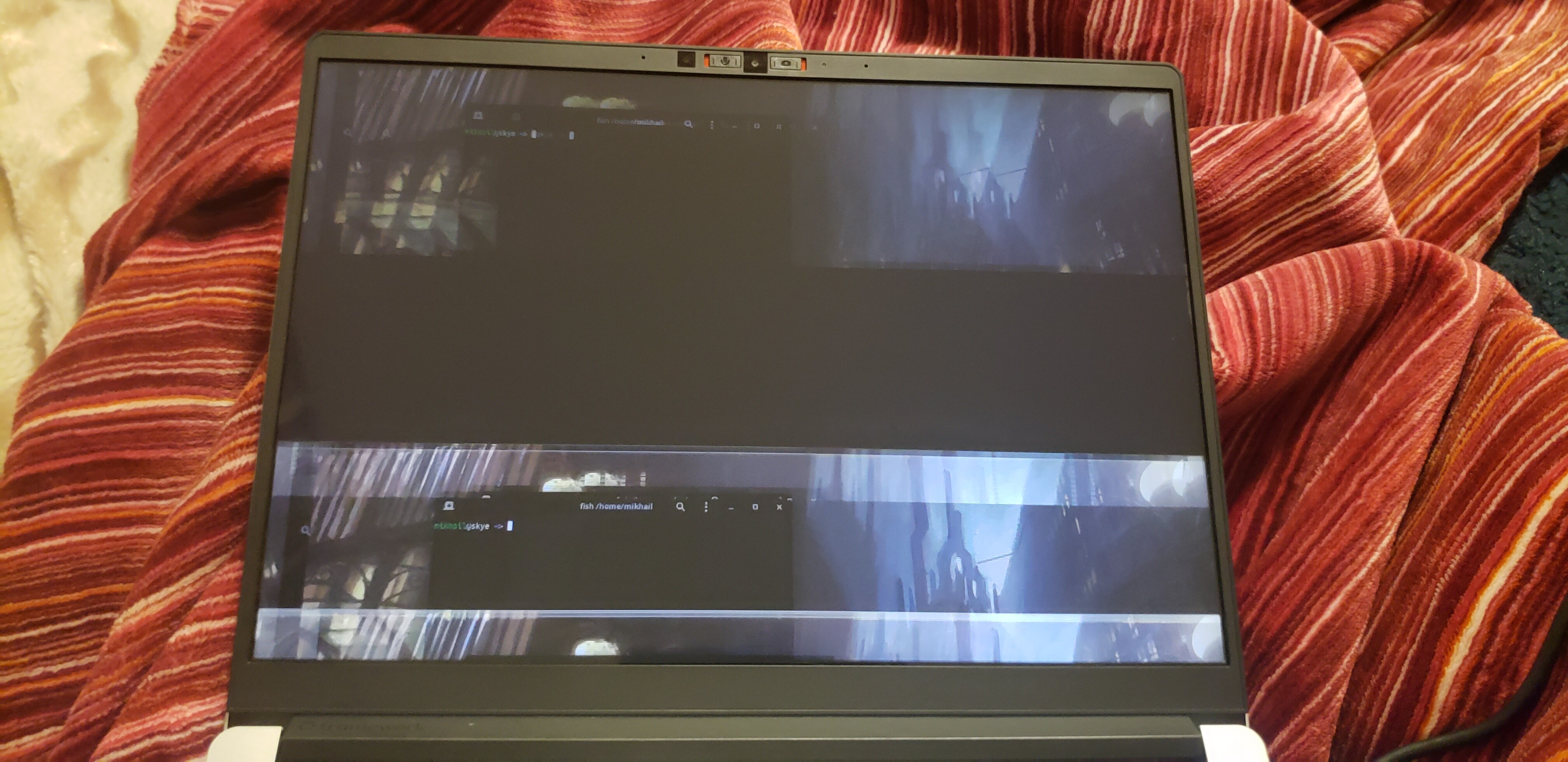

@Julian_Joaquin I could never get that solution to work properly. It works just fine whenever I do after boot and login and then setting it manually. However, as soon as I add it to my .xprofile and having it run on startup completely breaks the display where there’s massive flickering, each line on the display is misaligned, the top of the display are repeated on the bottom, image sliding left and right rapidly, etc and no matter what, there’s no way to fix it other than entering another tty, commenting out the two lines, and then rebooting.
I’m running on Solus Linux if that explains anything at all.
I’ve settled with slightly modifying my scaling the output solution to adding a new mode with the resolution of 2820x1880
xrandr --newmode "2820x1880_60.00"  453.75  2820 3044 3352 3876  1880 1883 1893 1948 -hsync +vsync
xrandr --addmode eDP-1 "2820x1880_60.00"
I’ve tried both the cvt and gtf output of 3000 2000 60 but both produced the same result.

I had the same exact issue when I placed the script in .xprofile. For lack of my own understanding, the script executes at a specific time that causes the screen to just glitch out like that. I found that running the script at the time when other applications autostart seems to work. As I mentioned previously, a .desktop entry under /etc/xdg/autostart/ pointing to your script should do the trick.

Long-time follow-up to this issue, I’ve stumbled into this exact problem by accident and was able to reproduce it. Scared the hell out of me and my colleagues when we saw the screen flicker like that.
It seems that whenever a new mode is added to the output display for the first time since boot the screen, for lack of better terms, glitches out erratically. This mainly occurs whenever xrandr --addmode or --mode is executed for the first time.
This is reproducible by executing the two aforementioned lines in either .xprofile, .xsessionrc, or in a .desktop entry under /etc/xdg/autostart.
I was able to find a work around by changing the mode at least twice before using our custom mode. Something like this works:
xrandr --output eDP-1 --mode 3000x2000_60.00
xrandr --output eDP-1 --mode 2256x1504 # It doesn't matter what mode here
I don’t have the slightest clue why this works, it just does. And quite frankly, I don’t understand X11 enough to sift through the documentation. It would be great if someone could explain this behaviour.
