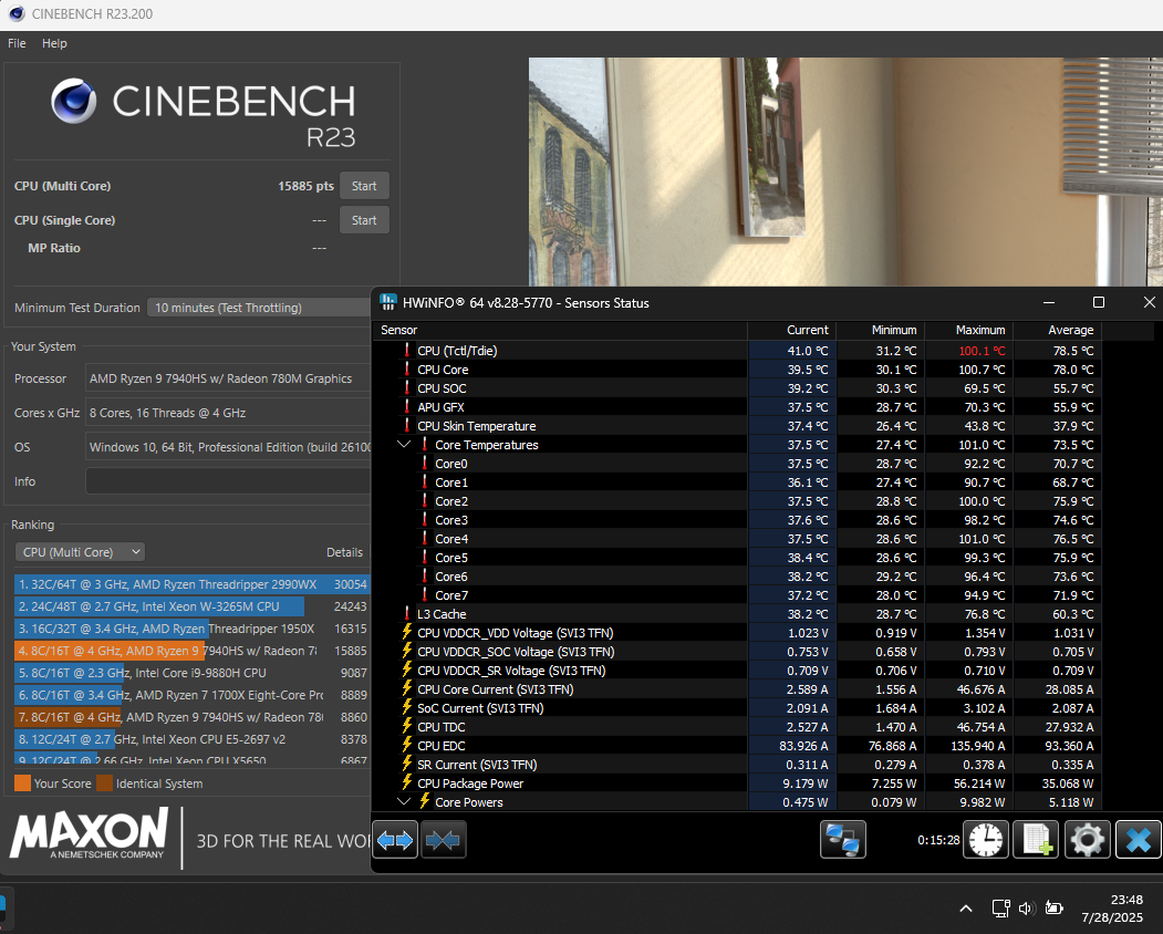

Been following this thread and finally got my PTM in the mail today. Just did a swap this evening and booted up right after. Let idle for maybe ~10 mins and figured why not, lets see where we are at. This was literally right after the swap. Was around 47 cpu package power the majority of the 10 min test, but toward the end it was consistently around 49 and even stuck on 50 every few seconds. Differences between the cores are also MUCH better. Was seeing ~20 degrees difference between the coolest/hottest cores previously. Needless to say, fairly pleased with the result right after the swap. (Was in the 14,000s before swap). Power plan set to performance and battery actually locked in bios at 80%. HWiNFO probably ate some of the score but I know I was reading from some folks that performance should go up after ~10 cycles for that burn in period. Time will tell.
Edit: Forgot to mention that this is not in over clocked mode and I am running a -20 curve undervolt..

Just got back into town again and my laptop has been off for a few days.. Decided to do another test (2nd boot & test since repaste with ptm). Very pleased with the product Honeywell has created.
Edit: Snapped that literally after test finished and cpu was still coming down which is why current temps were still a bit high.. And again, this was without any modification to the heat sink like many others have done.

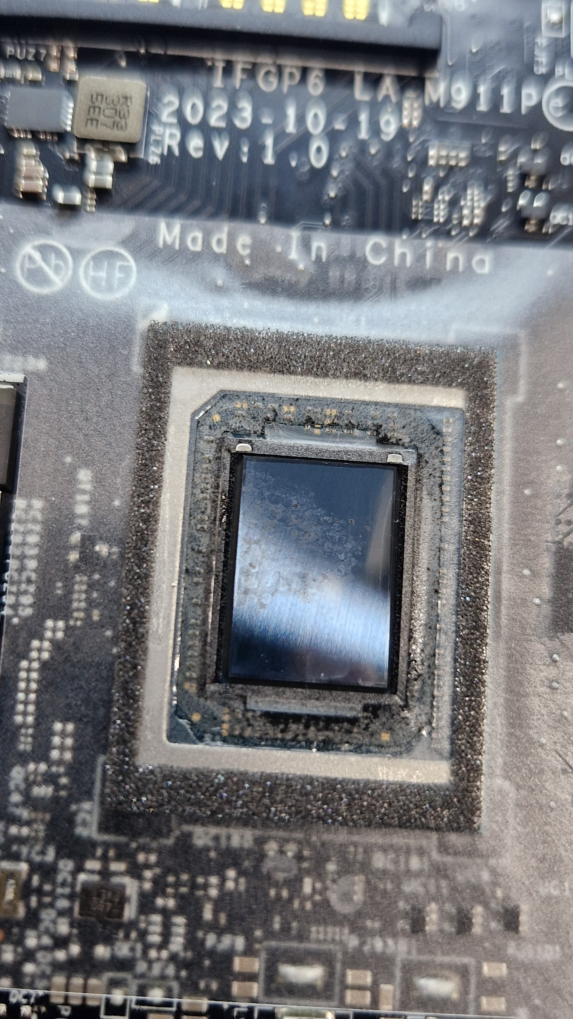

After opening everything, I knew why my FW was constantly hot: Basically no LM left on the CPU.
The scariest part of the process was peeling off the heatsink, and the few long seconds when booting up the computer again.
So far my FW feels much cooler, which is really no surprise looking at how bad the LM looked.

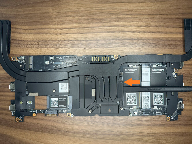

I would recommend rotating the cooling assembly a bit back and forth and not prying. The die can stick to the cooling assembly and you may risk issues with ball grid array underneath.

Count me in as a happier customer after the PTM replacement. Like others, all of my liquid metal leaked out and there and what was left just covered 1/4ths of the CPU:
