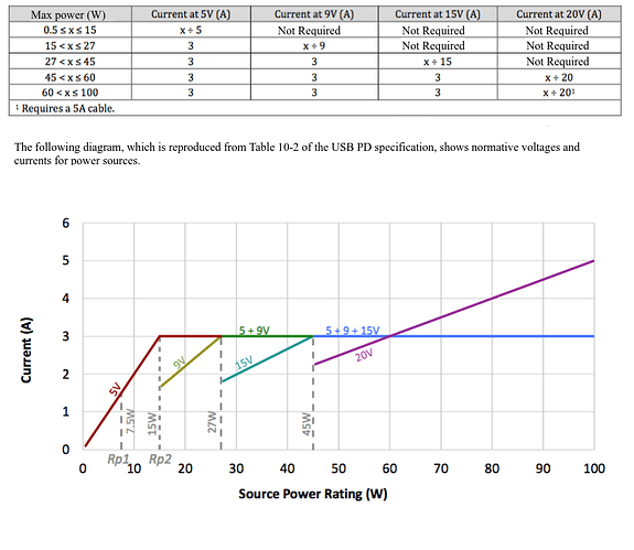

what kind of amps does it need if it is charging @ 60W? My charger says it has can only output 12 amp
@MaineDan
Howdy. You may be reading the wrong stats on your charger. USB-PD chargers only go up to 5A (at 20V) for a delivery of 100W.
Here is a graph describing the modes that USB-PD will negotiate to:
If this doesn’t answer your question feel free to post a photo of the data on the power supply and we can have a go at deciphering.

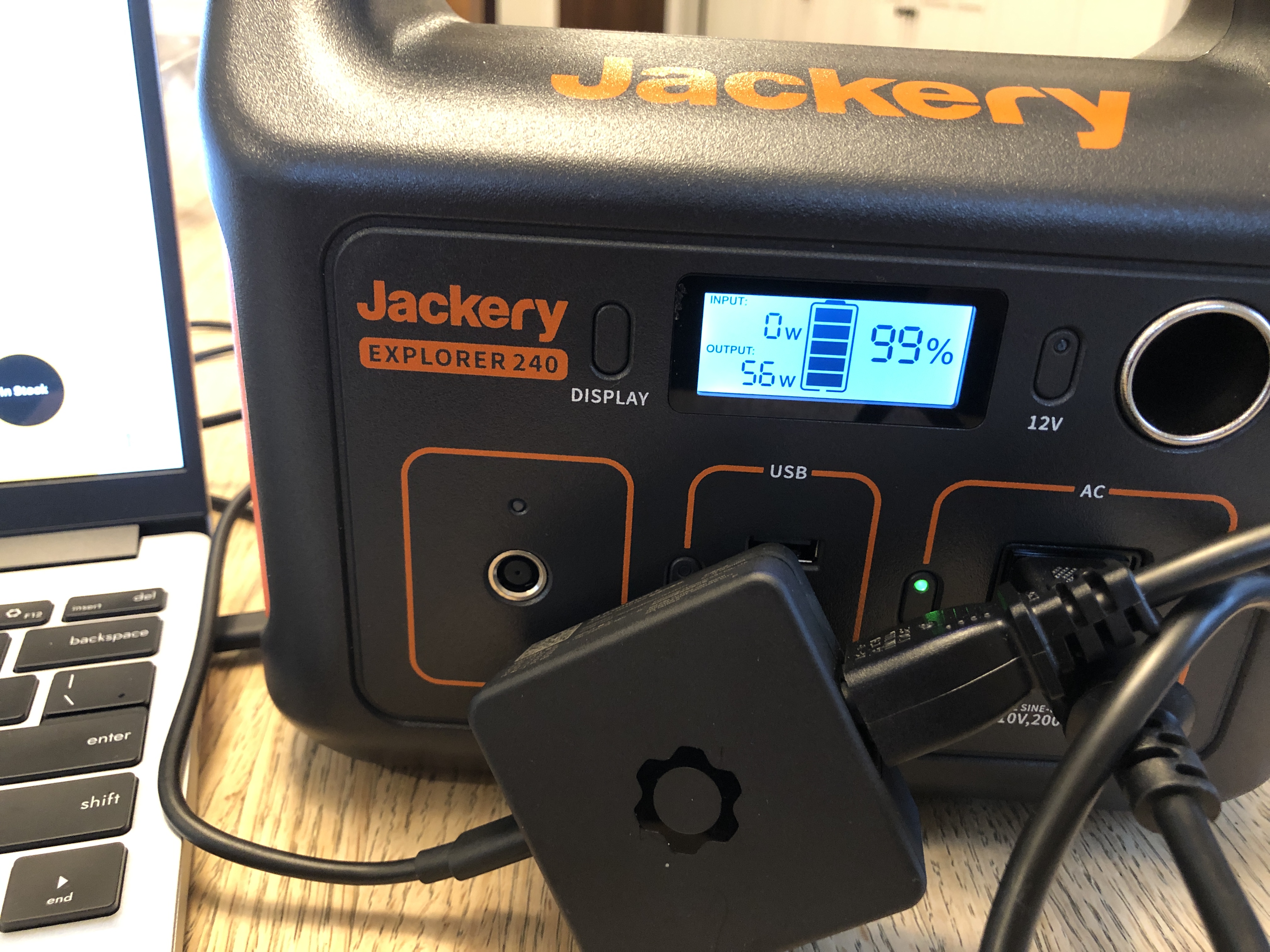

Would this work for you? Portable AC with 240 watt hours.
Why not stick a 12VDC to usb-pd in the “cigarette lighter” socket? Yes DC->DC boosting is not perfectly efficient, but it has to be more efficient than DC → AC → DC. I found a 100w one for 16 bucks on Aliexpress yesterday…
It’s a little tough to pack a Jackery into a car dealership where I could be waiting for three hours, in a chair in the middle of a room with no access to mains power. My frame.work laptop battery only gives me 90 minutes, these portable and light solutions fit inside my briefcase and give me better power choices.
