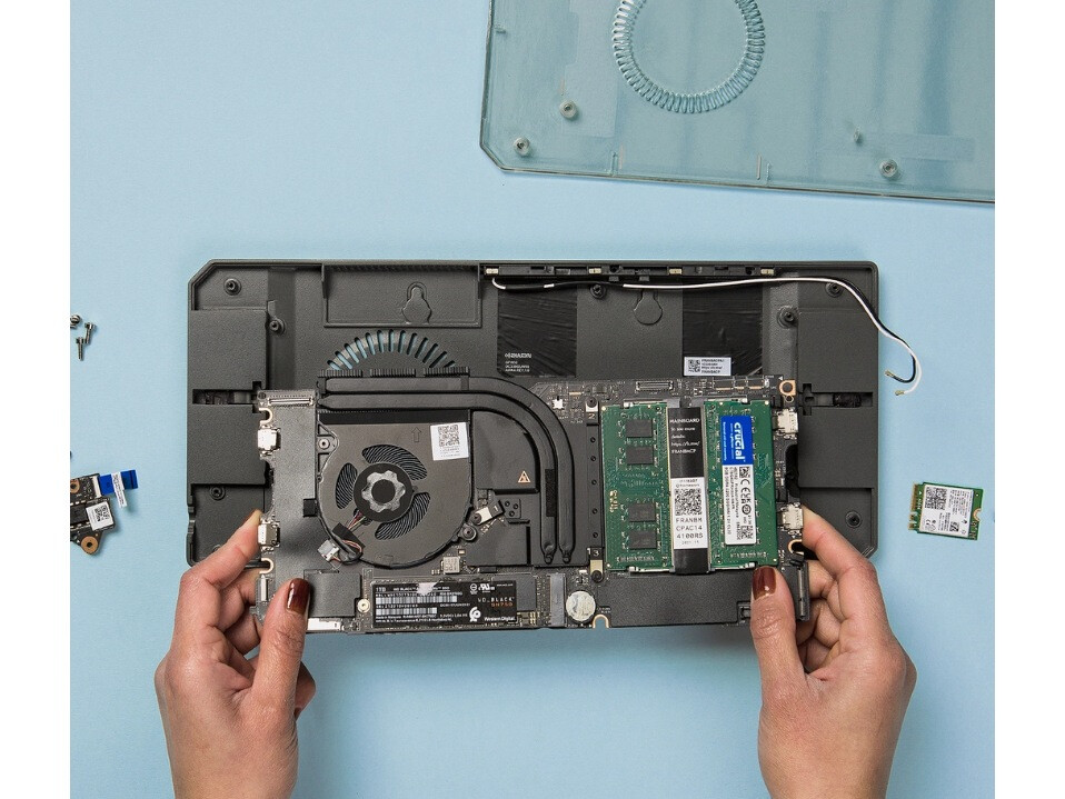

Would it be practical to reuse the antenna out of the FW13 in the cooler master case?
I decided to go with a full upgrade to the 13 Pro (have a pre-order in already), and I’ve been thinking about what I want to do with my original 11th gen. Right now, my plan is to get the cooler master case and move the mainboard over to that so I can use it as a mini desktop / HTPC.
Looking at the information for the case, I see that there are a number of components that are optional that don’t come with the case, namely the “audio board” for the headphone jack and the wireless card and antenna for wifi/bluetooth. I figured that, since I wouldn’t be using the laptop without a mainboard in it, that I would just transplant all the parts out of the laptop anyways. Looking at the replacement guides for the parts, it seems like the audio board and wireless card will be easy enough, but I’m worried about the antenna.
In particular, Step 10 on the replacement guide indicates that I’ll have to peel off adhesive-backed pads off of the top cover. My concern just looking at the guide is that either I will damage (eg tear) the pads, or that the adhesive won’t be meaningfully reusable after removing the antenna. I’m not 100% sure how important those pads are, especially on the cooler master case (which is plastic, unlike the FW13 chasis), or even if this is something to be worried about at all.
Has anybody tried removing the antennas from a FW13 before? Would I be ok reusing the antenna, or should I just buy a new one for it? I know I can just order a new one off the marketplace (or just getting the SMA to U.FL/MHF4 cables and use external antennas), but I would like to know before hand whether I need to go that route, or if I can save the money (since the WiFi would only be as a backup, and I would only occasionally want to use the bluetooth, so there isn’t a ton of value to having it for me).
