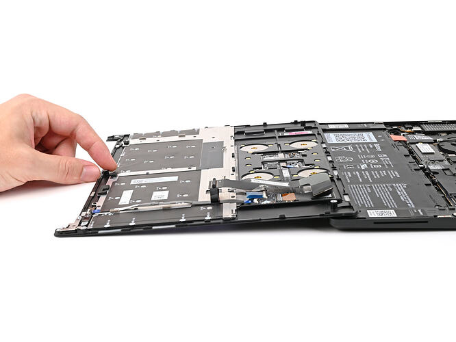

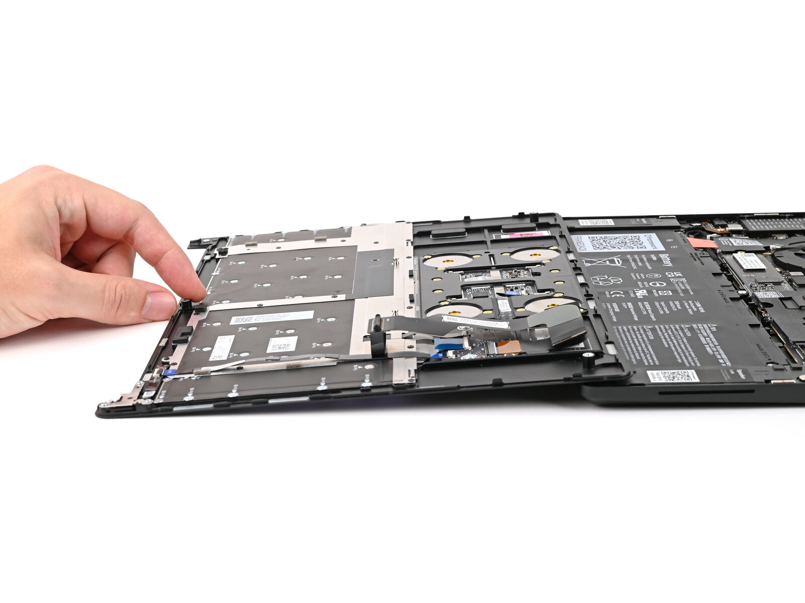

I have not found a lot of pictures of the underside of the new input cover (found this odd angle one from ifixit).
The touchpad section seems pretty much full, don’t think you are going to fit another 2 big chips (hub and micro for zmk) plus their passives in there might be some space on the board that connects the ribbon cables together.
