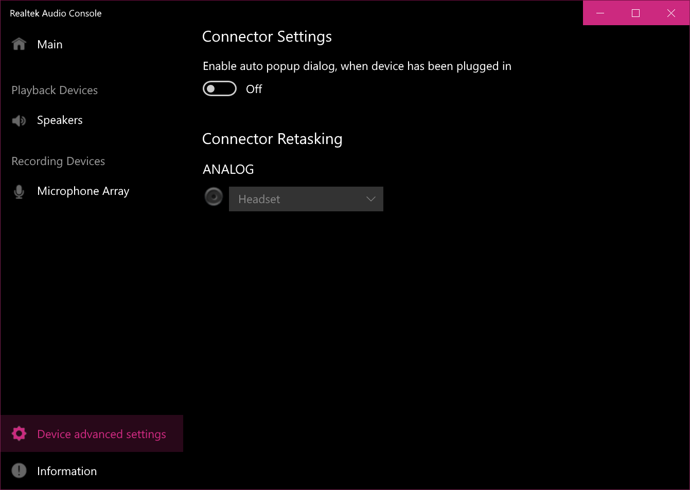

Not sure if this is the same on Win 11, but try searching for ‘Realtek’ in the Start Menu and open up the Realtek Audio Console. In the ‘Device advanced settings’ you should be able to specify ‘Headset’:
I don’t have the Realtek Audio Console installed - I did just update to the newest Win11 driver package from Framework and noticed it says the Realtek driver is “Only installed on systems with Realtek Audio Codec”. Judging from this blog post - Framework | Solving for Silicon Shortages - I’m guessing I have the newer chipset on this December-delivered laptop.

From what I can see Tempo lacks the utility software support that Realtek has - so ports don’t seem to be reassignable in any way that I’ve found yet.
